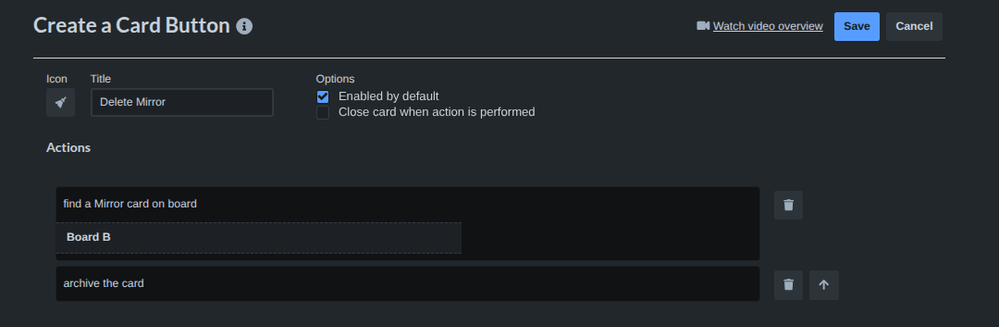

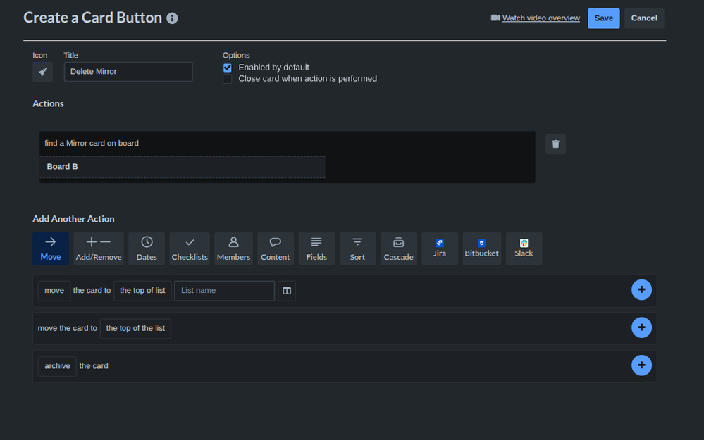

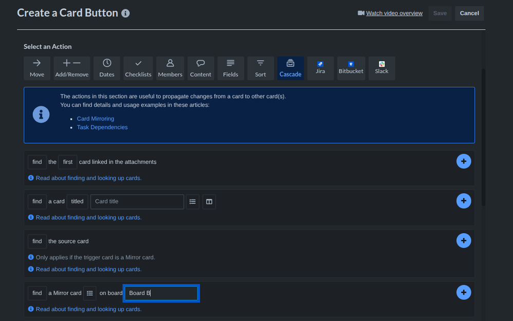

You have to use a cascade action in automation. I have shown the actions below:
find a mirror card on board "Board B"
archive the card
Full automation
