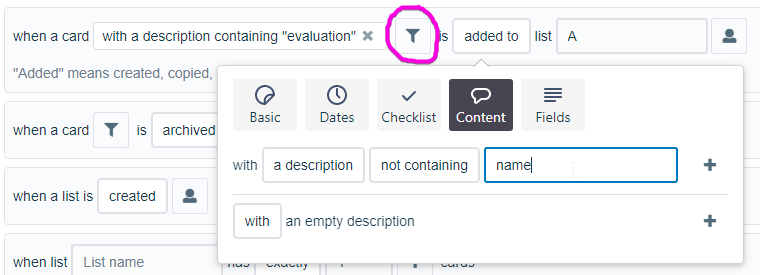

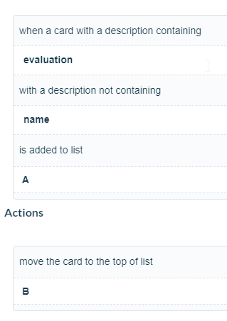

You can stack filters (the funnel button next to 'cards').
In the same way that you added a filter for the trigger to only work on cards who's description contain the word "evaluation". You can just click the funnel button again and add a filter for descriptions that don't contain the word "name".
The rule will then only trigger if both are true.

Vongsawat
March 10, 2023
Its a single trigger, but with additional (stackable) conditions.
Its the Funnel icon, its only visible when you're selecting the trigger itself. So when the Rule triggers on a Card, you can add additional conditions for it to only trigger on Cards that contain certain text, has a certain name, does not have a certain label, etc.
Once you've selected the trigger, you can't edit the conditions configuration, without removing the trigger and redoing things. (though you can change the text fields, such as what text the description must contain for the trigger to run, etc.
