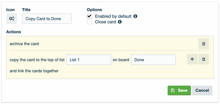

Sorry if there was an expectation that Trello would do this, but it does not.  Instead of moving the card, it might be possible to use the copy function instead, and then link the copied card together with the original one.  The copied card won't have that previous activity information, but it would allow users to traverse the linked cards to find the original to see that information if needed. Here’s a screenshot of an example rule.

I appreciate your answer, but it does not solve the issue. My goal was that once a card has made it's way through each column of board; a member could simply click a button on the card and move the card to another board where it begins moving it's way through that department's board (Trying to organize each board by department). Even if we couldn't use the butler button; I would be happy just moving the card and knowing that I won't lose information. If I'm reading your suggestion correctly... A member from one department has to copy card and then go into the board of another department in order to add a link to the original card? Sounds like wasted effort to maintain records that should already be there.
