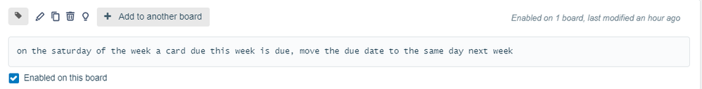

What I am trying to accomplish?
I want to have the due date of each card updated on a weekly basis.
Board setup

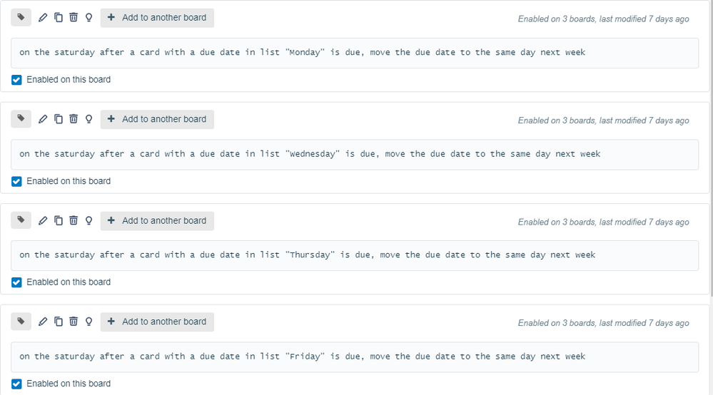

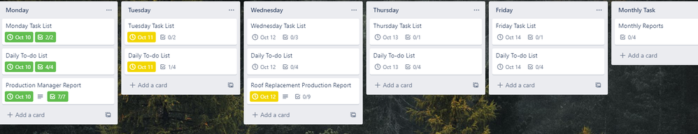

I have a list of M - F with about 2 - 3  cards in each list, I have attached a screenshot of my current board for reference. I also attempted to make two separate commands but I don't know if they are working correctly.
Any help is appreciated.
Screenshot 2022-10-11 104359.pngScreenshot 2022-10-11 104314.pngScreenshot 2022-10-11 104141.png
Rafael Dill
October 17, 2022
Hy Bryant, thanks for writing to us! Seems like your commands are correct on what you want to achieve. One thing that is worth mentioning is that you can click on the button that looks like a lightbulb to see the Command Log of it, which says exactly when the automation has run and if there are any errors.
Also, the first command you created works for every day of the week, so you don't need to create any additional commands to cover day-to-day. Let us know if you have any additional queries!
