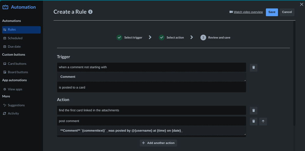

Hi @Kelly
Try this automation, enabled on both boards...

Yes, this worked like a charm! Thank you so so much! Not only for your help but also for your persistence with my problem.
(Do not forget to also put the ** in front and at the end of the word Comment in the trigger, it's so specific...)

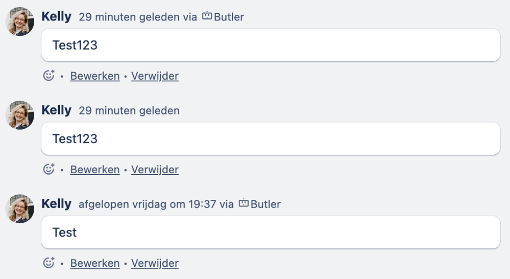

May 13, 2024
Tried both. Still the same. It doesn't change the fact that it's posting the comment on the original card twice.
When i use a separate Trello account and set the automations on that account (disabled them on mine) then it's posted on behalf of that account again but it's still double (one from me and one from the bot)
And that's the same when i use the other options. When the comment is posted it is repeated (my client posted the question and my account repeats the comment) so there is always the same comment twice. Of course i could explain this to my client but i rather not...

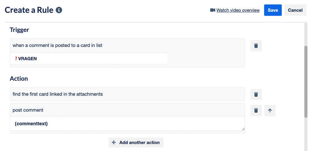

I have separate board with clients. They ask me questions in the list ?VRAGEN. When that happens the the following automation starts:
when a card is added to list "❓VRAGEN", copy the card to the top of list "?VRAGEN VAN KLANTEN" on board "Dashboard" and link the cards together
So that al the questions i get from different clients gets bundled for me on my dashboard board in the list ? VRAGEN VAN KLANTEN
Then i have the automation on the board of the client that also the comments in the card get synced to the linked card (on my dashboard). I made this in a separate automation:
when a comment is posted to a card in list "❓VRAGEN", find the first card linked in the attachments, and post comment "{commenttext}"

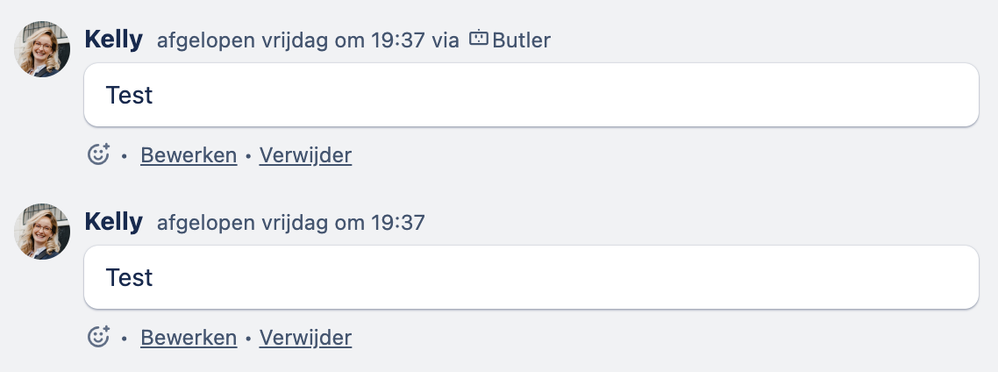

When the client now make a comment. You see this:
First her comment she made and then the one butler is posting again.
On my dashboard board in the card i only see one comment.
I also have the automation that my comments get copied back to the card on my clients board:
when a comment is posted to a card in list "?VRAGEN VAN KLANTEN", find the first card linked in the attachments, and post comment "{commenttext}"
And also there, when i make a comment. I get the same comment again posted by butler:
