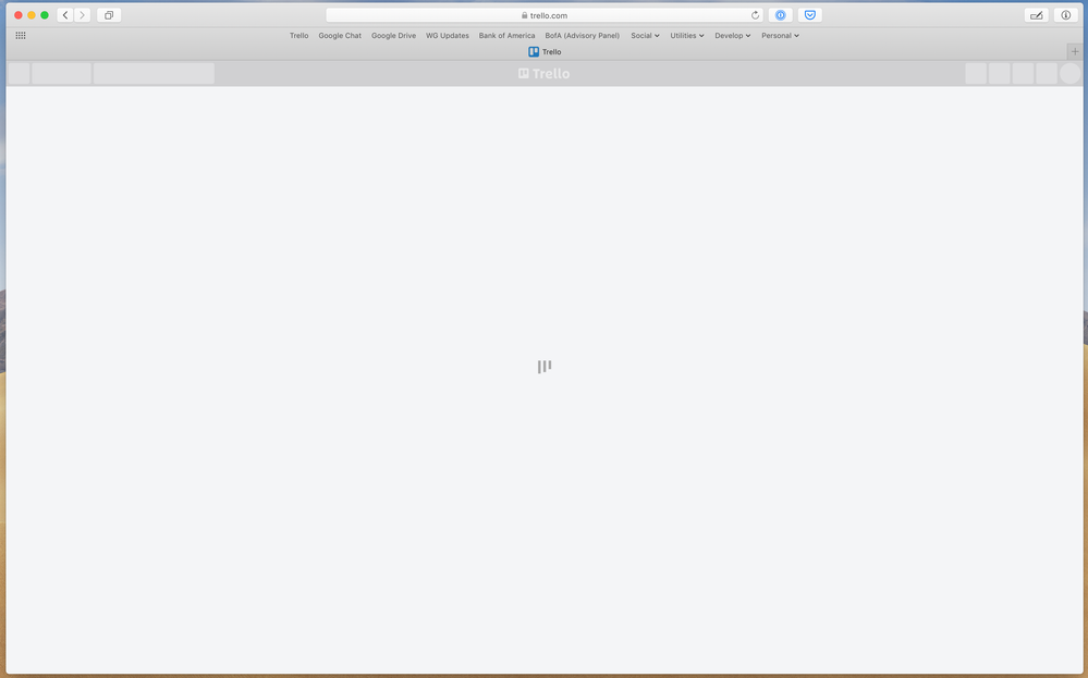

Anyone else experiencing the same thing? I don't have access to my Trello boards on two machines (both running the same macOS, both just after Safari update). Just "Trello" at the top, empty button in the top bar, loading animation in the center.
Still can access with Trello app.

Yesterday we were able to find the cause of the issue and implement a fix. The problem was isolated to the recent Safari update (14.1) on macOS Mojave. The fix should be rolled out within 48 hours.
For anyone that may be interested: it was caused by using the 'compact' notation for the Intl.NumberFormat API. We use this to localize shortening of long numbers. e.g. presenting "1,825,602" as "1.8M". For now we've switched to 'standard' number formatting for Safari 14.1 on macOS as a workaround while we continue to investigate the changes in Safari that cause compact formatting to fail.

Definitely having the same issue here. Was wondering what was going on. The Mac App from the App Store and Chrome both work fine, but in Safari, after updating, it's stuck on load. Seems to work fine in Safari on mobile and all mobile iOS apps as well. It's just the Mac Desktop Safari browser 4.1. I'm on Mojave 10.14.6.
