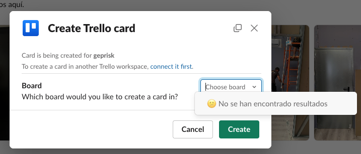

Captura de Pantalla 2023-08-24 a las 12.05.26.pngHello!
I have a problem with the integration between Trello and Slack. When I go to create a Trello task from a Slack conversation, I don't get the option to see which board I can send the card to. Any idea why I can't see it?
Thanks

Hey Julio,
Vishaal here with the Trello Team—Thanks for reaching out
 Could you  try:
  • Opening that board
  • Clicking the Slack icon at the top of the board
  • Click "Add Alert", then choose the proper Slack Workspace and Channel from there.
On the Slack side, could you type "/trello create"? If you don't have the option to create a card or select a board, could I ask you to verify if you're added to the Workspace in which the board is present in Trello?
Additionally, Can you try resetting the linking in Slack, by using these two commands in sequence?
/trello reset
/trello setup
Let me know how it goes!
