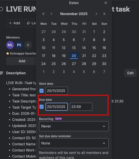

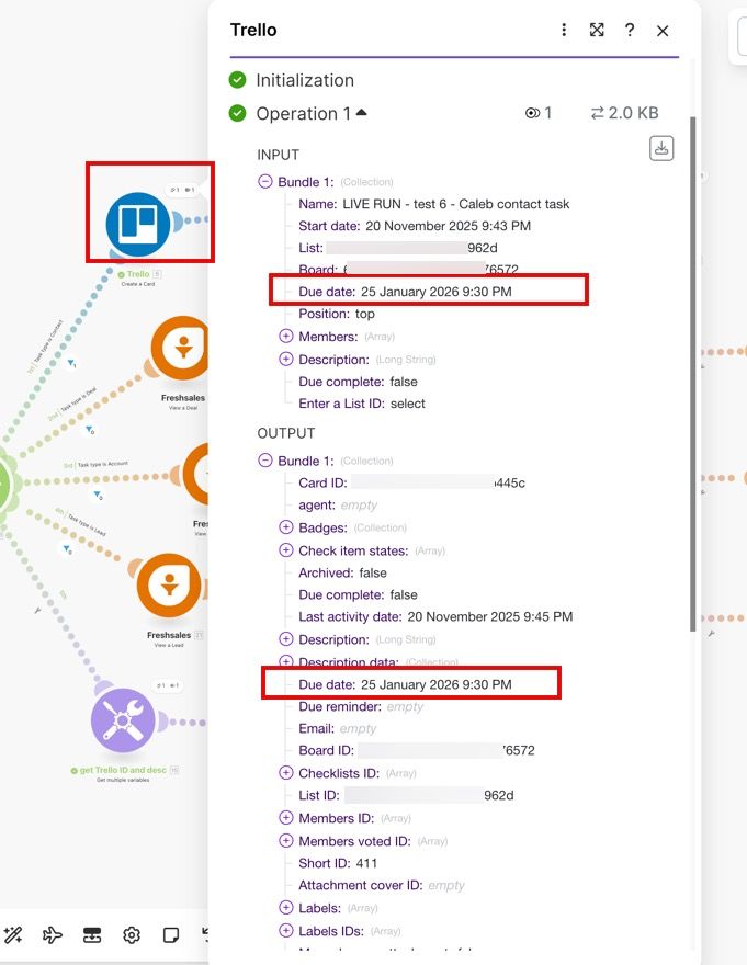

I have integrated Trello into my Make scenario to create a Trello card based on input from my Freshsales Task. The Trello card is created successfully but the Due Date is set as 20 Nov 2025 23:59 (the end of the day of the execution). The due date for the Trello card when created in Make is set as 25 Jan 2026 21:30.
I have discussed this with the Make support team and they have reviewed the raw request to Trello and the return from Trello. This all indicates the correct date of 25 Jan 2026 21:30 is sent and received.
I have attached two images. One showing the dates provided to Trello for the due date and the other image showing the Trello card with the incorrect due date.

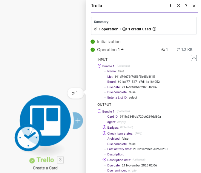

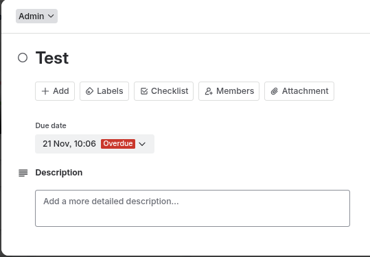

I am both a Trello and Make "expert" so hopefully I can help here. I created a quick simulation on Make and it worked fine for me (note difference is because Make is set to a different timezone to Trello):

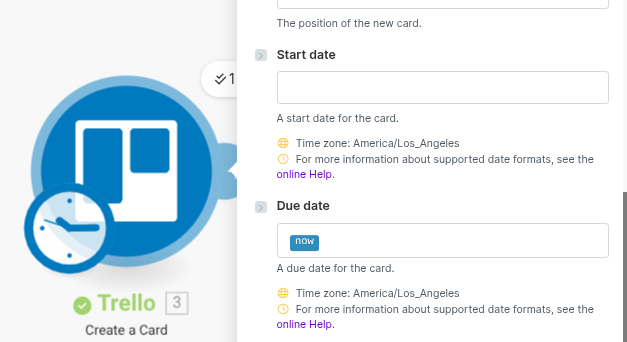

  2. In the make scenario, temporarily switch out your mapped date to the {{now}} module and run it to see if the date is then correct

I tried your suggestion and entered {{now}} for the Trello due date. I would have expected it to have said 24 Nov 2025 16:55 and instead it shows as 24 Nov 2025 23:59. I also removed the date from the start date and it made no difference.
