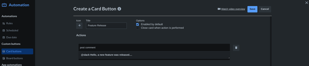

A workaround is to have your button automation there to trigger another automation:
The example below has a bonus of you being able to send ad-hoc messages to the slack channel also...
Button automation:
Note: replace the text after @slack with your own

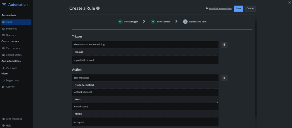

Then do an automation rule as below:
Note: replace the slack channel name and workspace with your own
