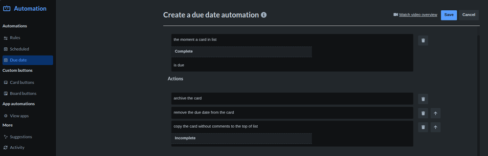

Hi @jrudin
Did you know, when you copy a card, it resets the checklists and removes all the comments so you have a clean card?
You want to use copy card instead of move...
This means your process can be when the due date hits, achive the card and then create a copy in the incomplete list
This automation will do it.
I added to remove the due date as I'm guessing you don't want that to be on the copy card...
