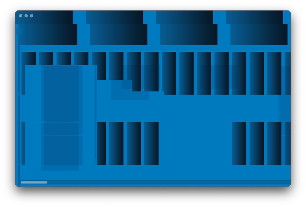

Hi. The Trello app on my iMac has stopped working. When I open the app, I am greeted with the screen below. This is the second of our Macs that this has happened to now. Is this a known issue and is there anything I can do to fix it? I'd rather use the app than a web browser to see my board. I've tried uninstalling and reinstalling the app, but it doesn't make any difference.
The Mac is an iMac running Monterey 12.7.6
Thanks for any help.

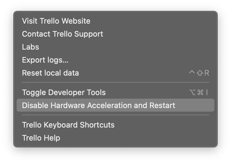

I may have found the solution. Under the help menu, I had an option to Disable Hardware Acceleration which appears to have fixed the problem.

Tim Roberts
September 23, 2024
Have just tried that and it seems to have done the trick.
Thank you!

rhianna
October 23, 2024
This worked for me too as was having the same problem - thanks!
