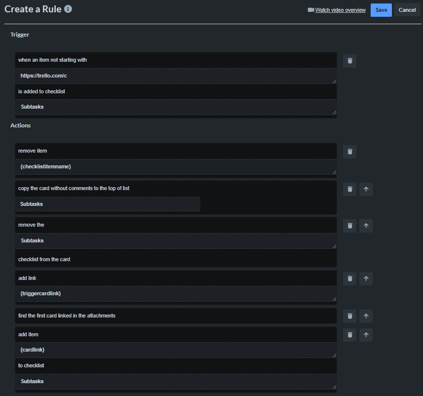

To my constant annoyance, it isn't easy to lookup custom field values from a linked card. However, in your case, I think there is a solution...
Luckily this is a scenario I have had before too...
It is a relatively tricky one, however...
Instead of convert the checklist to card you actually copy the card with automation...
Here is the automation:
Note, you have to have the condition "when an item not starting with https://trello.com/c" to stop an infinite loop.

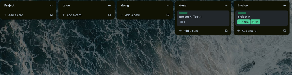

After the child card are moved to the done list. I have created a action that the parent card moves from the project list to the invoice list.
How do I get all the child card to move as well?

I think the first automations would be:
1)
When the checklist "Subtasks" is completed, move the card to the list "Invoice"
2)
When a card with the checklist "Subtasks" completed is moved to the list invoice, for each item linked in checklist "Subtasks", move the card to the list "Invoice"
Do you really want the subtasks to go to the Invoicing list though?
In setups like this, I would have an automation that archives the subtasks when parent card moves to "Invoice Paid"
