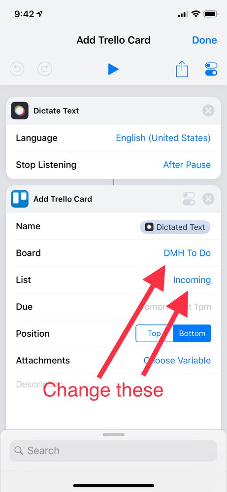

I have been trying to figure out why this wouldn’t work for you when I realized it’s probably because it’s looking for my board and list, haha! So you will need to edit the shortcut by tapping the three dots in the upper right corner of the shortcut itself in the Shortcuts app. Then in the group titled “Add Trello Card”, make sure it says:
  • Name: Dictated Text (should be a little bubble thing that shows it’s taking what you said from the first Dictate Text step)
  • Board: [your board name]
  • List [the list you want it added to on that board]
Then it should work! Here’s an image showing what you should change:
Let me know if this doesn’t work for you. I also realized, belatedly, that TickTick is probably just syncing your Reminders to its service, which is a much easier process. Unfortunately, Trello doesn’t support this natively, but a service like IFTTT could easily set it up. You would just create an Applet that says anytime a new iOS reminder is added, create a Trello card. It’s free!
Hope this helps :)

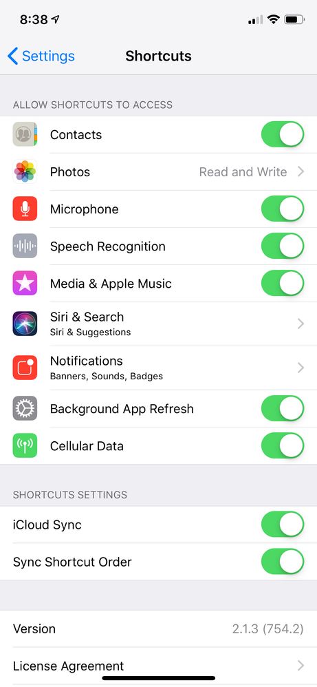

This doesn't happen to me, that's so weird! Mine prompts me to tell Siri my message and then converts it to a Trello card. Can you make sure you have all of these turned on in your Settings? (Settings app > scroll down to the Shortcuts app)
Lindsey_Ross
February 14, 2019
You know what, I think I just had a setting off b/c I was not familiar enough with shortcuts yet. I tweaked it a little bit earlier this week and got it working now!
