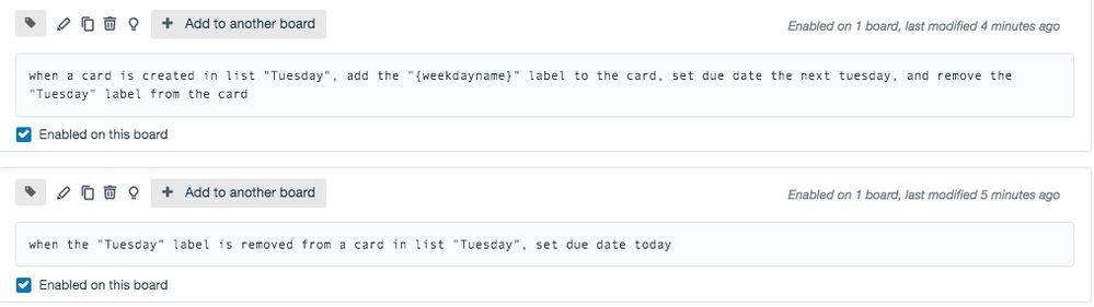

When you create a new card include a label that has a name using a date variable for day of the week (invisible) and use that to trigger the due dates. It should work.

Card added on Tuesday is due now...it kind to travel to the future and back.
Will wait till tomorrow to add a card because it will have a Wednesday label and next Tuesday due date and will remain "as is" since the second trigger would fail.

Hi @milynnus , this is super smart! You guys are amazing! Thanks a lot for your help!

FYI, I tested with a new card created on List "Tuesday" the due date is next Tuesday Aug 3.
