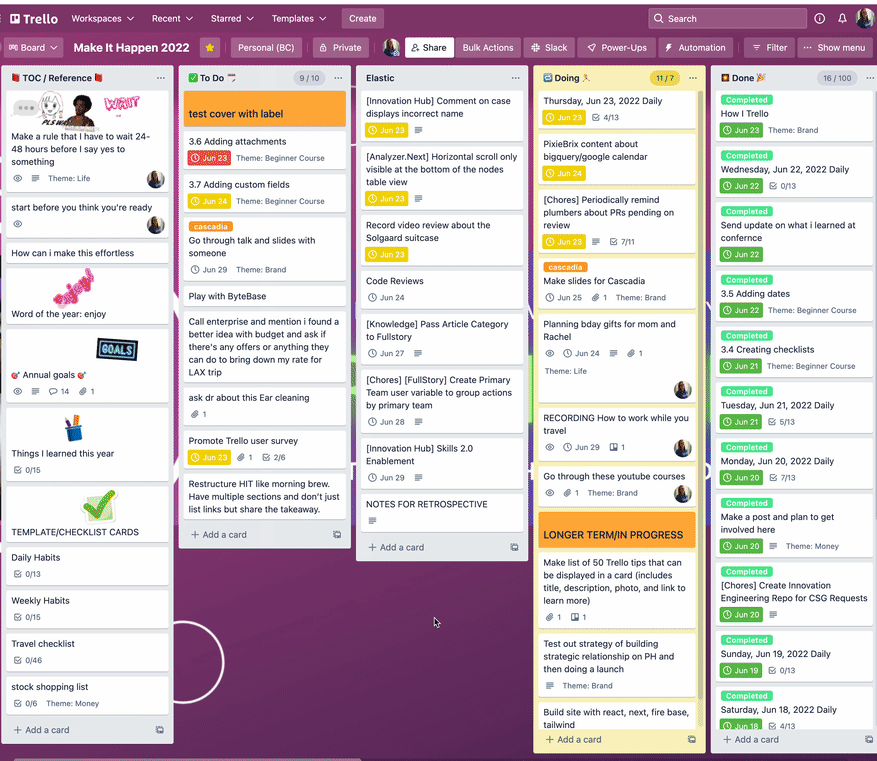

I have recently seen behavior in my main Trello Board where the cover cards on the top of the lists are being driven down to lower positions in the list. i am not sure if I have some automation set up that is causing this, or what other gremlins may be in my Trello Board doing this. Is there a way to set an absolute position on a card or cards so they remain on top or in second position in a list?

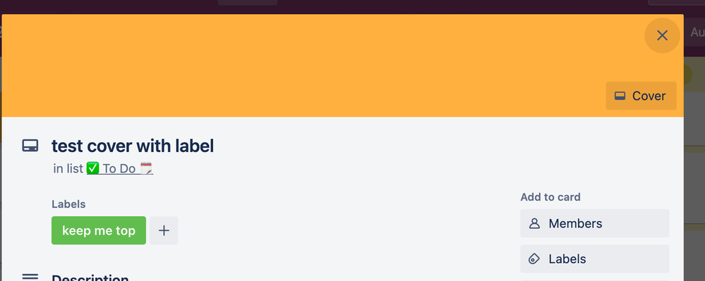

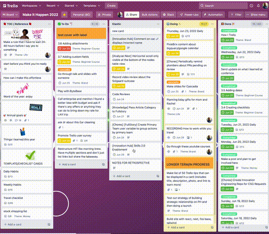

2- easiest thing to do is probably add a label to that card you want at the top (like "keep me first", and then you could set up a rule that anytime a new card is added to the list, sort the list by label (so that your card cover with the label is sorted first, and everything else after).
Don't worry - if you use the full card cover where it colors the card and not just the line at the top, it will actually hide the label so you won't even see it on the cover.
Here's what the rule would look like:
Just tried this out and it seems to work!
Let me know if this makes sense, and if not, I'm happy to record a quick loom explaining how to do it! (Might do that anyway haha)

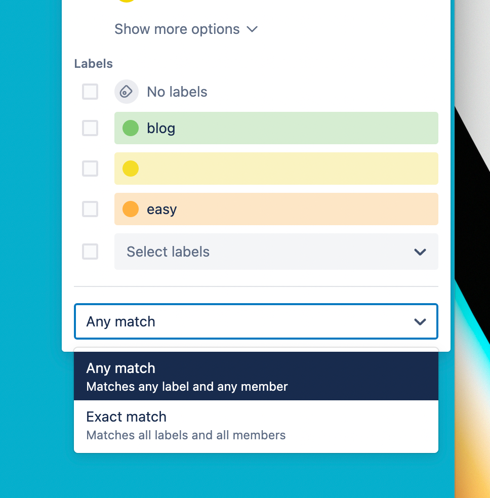

@Jeff Geurts yeah! just make sure you select the label as part of your filter! By default it will match _any_ thing that is in your filter, so if you add dates and members and the label, it should keep the label. If you don't see it make sure you have the filter settings for "any" instead of "exact" at the bottom of the filter menu.
