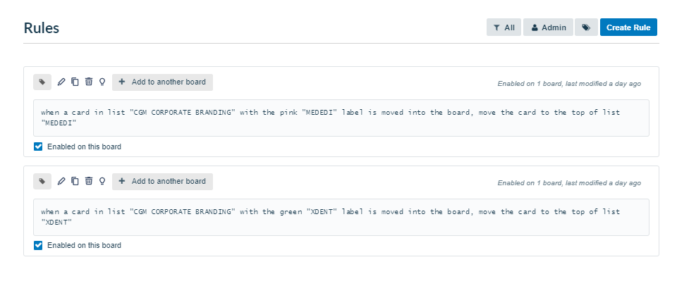

@Iain Dooley thanks for reaching out. Please see rules below. None of which are working.

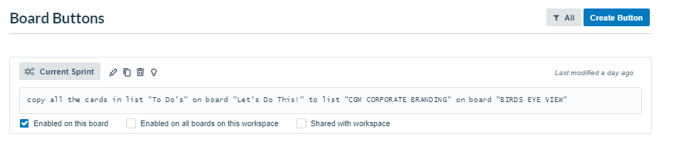

I've added a screenshot of the board button as well, this is working perfectly thanks.
I have checked commands and no error messages. I've also reached out to the trello team as we're thinking of upgrading to premium account but need to get these rules working first otherwise its not worth our while. Maybe I'm missing something? Board button.PNG

@Chantal Prince so when you say none of them are working, can you see in the command logs that they're running? For example when you click the button to copy all cards in liste "To Do's" on board "Let's Do This!" etc. you should see in the command log that it executed, and it should say if, for example, it couldn't find the list or the board.
For the second command, have you tried moving a card into the list CGM CORPORATE BRANDING manually from another board to see if it triggers? Also have you tried changing it to remove some of the filters or conditions and see if a simpler version works? Because I just created a command to add a label to a card when it's moved into the board in list "Inbox" and it worked, so I'd say there's a typo in your naming or something (again, the command log should help you debug that).

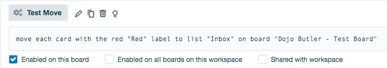

You are right. You do not need to use Cascade. Tested with this and it works for me.Screen Shot 2021-09-29 at 3.21.35 PM.jpgScreen Shot 2021-09-29 at 3.21.09 PM.jpg

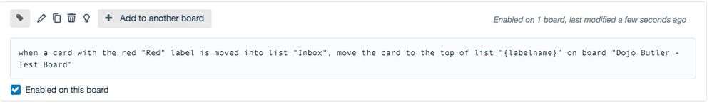

September 29, 2021
@Chantal Prince
If you use invisible labels and you use {*} it might work. Try it.
