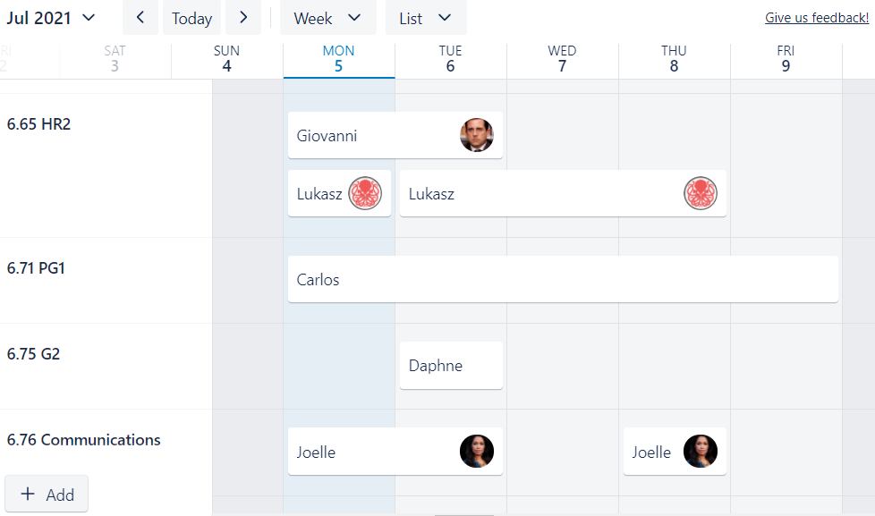

I'd like to use Trello to make a schedule to allocate colleagues sitting in our office on a rotating basis - something like a coworking space management.
I have set up lists corresponding to rooms, and have 2 labels - "regular weekly schedule" and "one-off occupancy".
I have populated the board with this week's schedule, and am visualising it in the timeline view:
Now, I'd like an easy way so that cards can be copied into the next week - and then the next, and so on. Bonus points if it can be easily and quickly done for the "regular schedule" label only.

So I found a way to copy a card into the same list, and so the solution I went with is quite a bit less complicated than the above. I created a button with the command:
copy the card to the top of list "{triggercardlistname}", move the due date to the same day next week, and move the start date to the same day next week
This makes a copy of the booking for the next week. Still requires some manual clicking, but for now it should do.

Hi Milynnus, thanks for your help!
So what I'm doing for now is I've created a card button with command
The simplest way for us to use it is that I click a card I want to copy over into the next week, on the back of the card I click "copy" and make sure it is copied in the same list, and then click my custom button. I end up with the copy remaining in place for the current week, and the original moved to the next week.
It would be great if I could have the copy action under the same button, but I cannot see a way to copy a card within the same list - the butler only allows me to copy a card into a specific list, but not into the same list.
