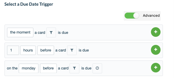

However you could probably adjust the trigger to be for "1 hour/day before a card is due". (see the middle option in the screenshot below)
Note this will apply to all cards with due dates, rather than those that you specifically set a reminder for. I don't think that's possible with reminders, as far as I know/have tested.

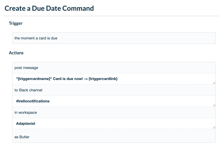

Here is the command in full...
