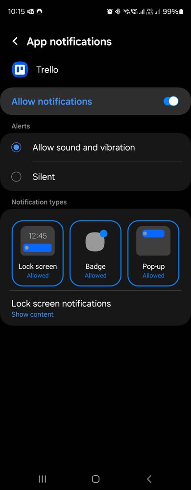

In theory that is exactly what I want to be able to do, however on our android devices when we click push notification settings, we only get this page. We don't get those options highlighted on that link you sent.

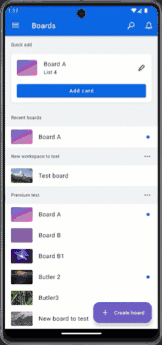

@Patch Bowen the screenshot you sent seems to be from the device settings. Could you please confirm if you see the same while accessing the notifications through the Trello app such as in the recording below?
@Carolina Hi Carolina, unfortunately when I follow the steps here, it takes me to the settings page I sent before. I'm using the latest version of Android and the Trello app.... don't know why, but I don't get this screen where I can pick the notifications.
That's unusual behavior. Could you please let us know which device you're using? I can check with our development team to see if this is expected.
@Patch Bowen , can you kindly let us know which device you're using? I'll check with our development team to see if this behavior is expected.
Hi @Patch Bowen
I checked internally, and it appears that Samsung added a setting to show notification categories, which is turned off by default: https://us.community.samsung.com/t5/Galaxy-S23/No-option-to-Manage-Notification-Categories/m-p/2829661/highlight/true#M36898
Go to Settings > Notifications > Advanced Settings, then toggle "Manage notification categories for each app".
You should be able to change Trello notification settings after that.
