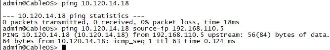

3.21.15:   no network issue.  cOS ping WAN IP OK

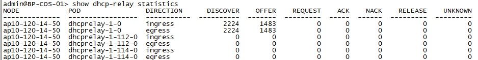

Upgrade to 3.28.2:  network issue.   Fail to ping any IP if no "source-ip" option.
CM didn't get an IP address from DHCP server.

The fact that ping only works when you specify a source-ip after upgrading from 3.21.15 to 3.28.2 points toward a change in routing, default source interfaces, or service IP behavior. This aligns with your DHCP relay statistics, which show DISCOVER and OFFER but no REQUEST or ACK. The handshake isn't completing, likely because the return path or interface mapping was altered by the firmware update.
I recommend opening a case with Harmonic Support and providing them with a clear comparison: the working version (3.21.15) versus the failing one (3.28.2), examples of the failing ping versus the working source-ip ping, your DHCP relay stats, and your routing table configuration to see if this is a known regression in 3.28.2.
