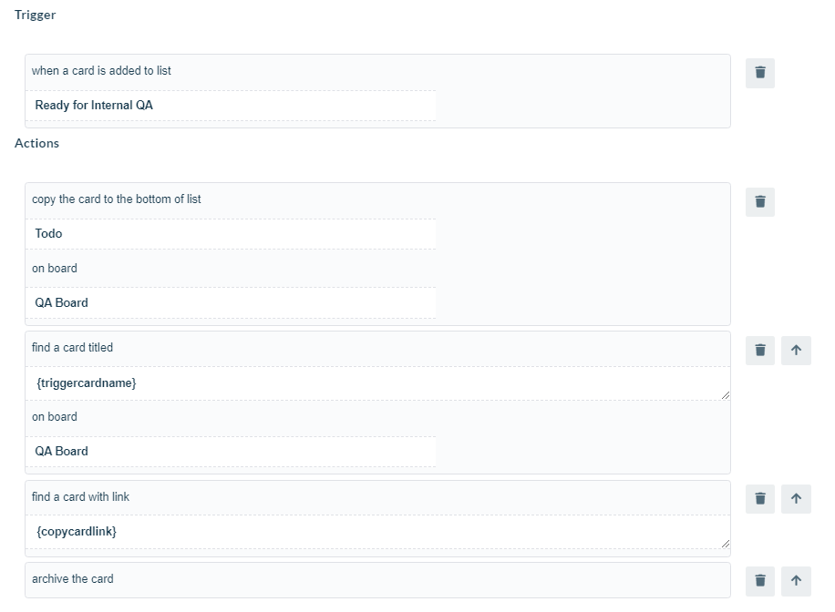

Huh. Kept thinking of more and more convoluted workarounds that imperfectly addressed this problem. Then I learnt something new.
If you Find a card by name, and the only card that can be found is the current card, the automation ends early.
Basically an [If this card has a duplicate name, do the following] command
The second Find is to ensure it jumps to the just copied in card and archives that, instead of the older duplicate.

Would the copy card execute first and then it would always find a duplicate?
Vongsawat
December 18, 2024
Automations always happen sequentially (though that can break down in certain complex niche cases you just have to trip over and exhaustively test to figure out..)
So the card gets copied first, and part of that command moves the Automation focus to the copied card.
Then it would search for a card with a duplicate name on the board and shift the Automation focus to it - or terminate the automation if it can't
If it did find the duplicate card, then it uses the second Find to switch the Automation focus back to the copied card. Then archives it.
Either way, you always want to exhaustively test out your automations (probably on a test board on a different workspace to preserve quota usage) to see if it works as planned etc.
