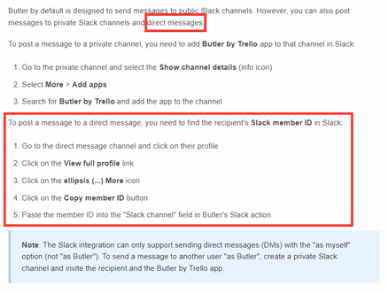

@Adam Johnson oh strange - it says in the documentation I linked above that you can send DMs.
I haven't tried it out myself, but if that looks like what you're wanting to achieve, and you're not able to set it up, maybe reach out to Trello support directly to see what's happening?

Definitely looks like the right thing; does not function as it seems it should Guess I'll contact support directly. Thank you!

 @Hannah Humbert - Simpla Workflows  @Adam Johnson
When I used Slack Member ID, it worked for me.
