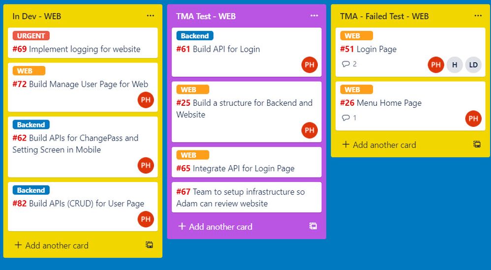

When is Trello going to provide basic functionality to display the number of an item and allow users to search on for the item by number.
Yes there are Addins to display the number .. but the number cannot be searched on.
Addins are no good .. you have to tell each member of the team what to install and what to setup.

Adam Hughes
June 24, 2021
@Iain Dooley  Each item in a list has a unique number.  There are addins available to display this.  It is a great way to quickly find and item
A user can say .. "See item xx" and I can quickly search and find it .. it is a quick way to find items on a busy board.
I have added and example image.
I use an addin .. but really it should be basic functionality (in my opinion) and I cannot search on it :-(

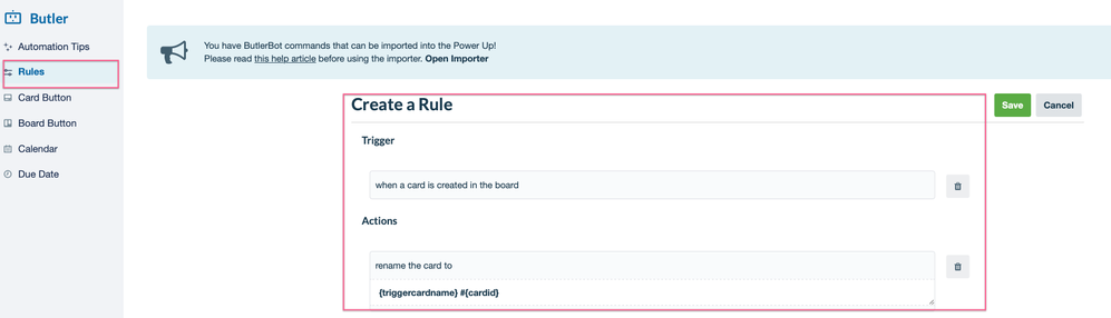

@Adam Hughes you only have to press the button for each card if you create a card button. You can create a rule instead and trigger when a card is created:
The IDs are unique enough that generally you can refer to the first 2 or 3 digits alone and get a unique result. For example if you wanted to filter the board to search for ticket zSkzx6YQ you hit "f" then type "#zsk" and you'll get the right card. So for example if you're communicate with a colleague and referring to a ticket you can say "hey look at zsk" and they'll be able to see what you're talking about.
Search for all cards on all boards (using the search function rather than the filter) will typically require you to type more of the ID in order to get a unique result (but it's not case sensitive so you can type all lower case). You can use is:open to restrict it to only cards currently open which means you will need to type fewer characters to get a unique hit.
The trouble with numbers is: where do you start from? How do you know what the last maximum number was? What happens when cards are archived and your numbers are repeated? What happens when you're search for cards across multiple boards? The number 61 will quickly become not unique unless you don't do very much, and once you're using a 6 digit number or something I don't see there is a tremendous benefit over having a 6 digit alphanumeric code.
Since all Trello cards already have a unique ID, it makes the most sense to use that. I've deployed this for a number of clients when it's used as an "order id" that's sent out to a customer, where a label is added to a physical asset with that ID and it's used as a 2 way lookup and so on, it works really well. Using numbers wouldn't work as well.
