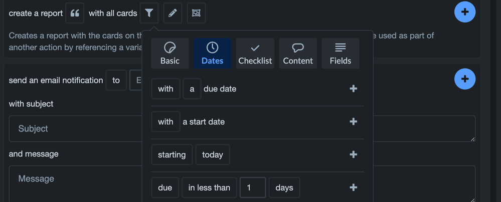

My automation that moves cards based on a complete due date doesn't work with the items marked complete without a due date and now I see there's no option for automation that will filter cards based on if they're complete. here's my legacy automation
"every wednesday at 2:00 pm, create a report in variable "Done" with all cards in list "To Do" with a complete due date using pattern "- {cardname} - {cardcheckliststate}", send an email notification to "****" with subject "{boardname} Report for {date}" and message "These are the items that were done at {boardname} recently:\n\n{$Done}", and move each card in list "To Do" with a complete due date to the top of list "Completed""
This is showing no option to filter based on complete status

There really isn't an option for marked complete within the filter drill-down of cards. Would it be possible for you to just set a specific label or list of cards you want on that report? That way you could use the filter drill-down option of that specific label/list instead.
All you'd need to do is add a supporting automation that adds that label or moves it to the list you specified for this whenever the card is marked as complete.

We used to be able to filter by cards marked as complete. I would generate a report containing all of the complete cards and then move them to the completed list. There's an option to archive cards marked as complete, but not add them to a report or move them. This really broke everything for me. It's not worth it to pay for a higher level of trello to add automation that will add a redundant label when a card is marked complete. I have a half dozen people added to my boards so that they can check in on any information that they need, but they don't use trello for anything other than occasionally getting information so it doesn't make sense for me to pay $35 USD per month. Is there any plans to add back the filter feature?
