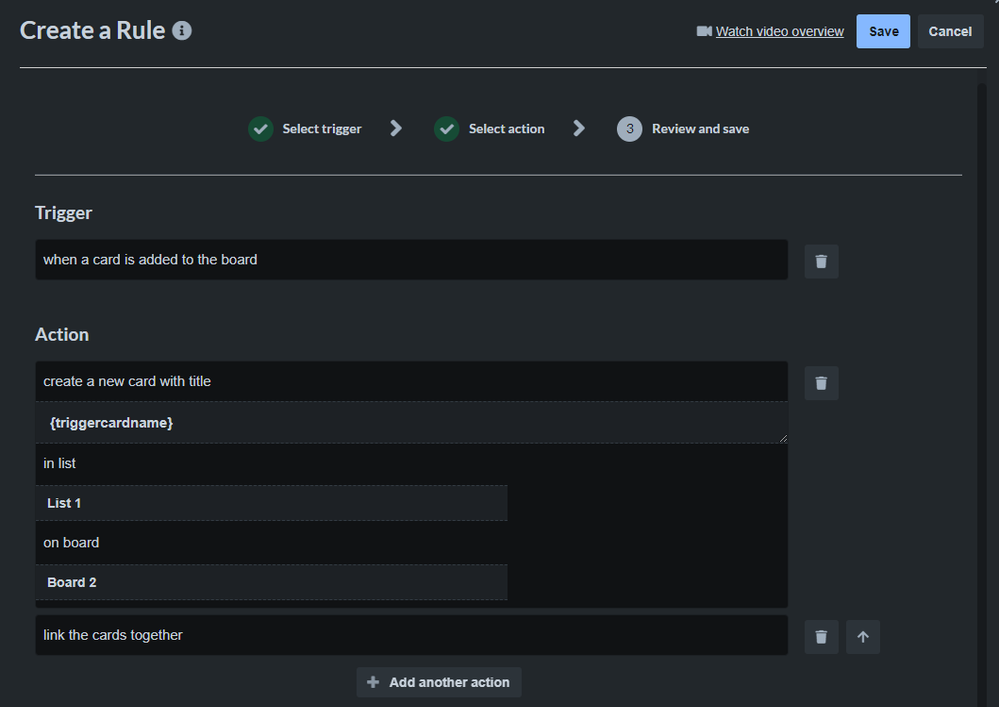

I have my trello set so that when I create a new card on my board, a duplicate card will auto generate on a second board. The only problem is I need the second card to be very simple and not have all of the information and checklists the original card has on it.  Pretty much all I need is the headline to show on the card. Is there a way to make this happen?

Hi there,
This should do the trick:
Note: The linking cards together is optional and will open up mirroring automations

THANK YOU!!!
