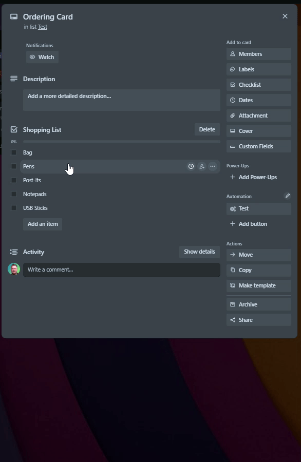

I can recommend an automation that will work, I'll use the shopping list example below:
Here I have an example where you have a checklist called Shopping List
When you check the items in the shopping list you want to order, it moves them to checklist Ordered.
When the items are received, you check them in the Ordered list and it moves to a checklist Received
This is how it looks:

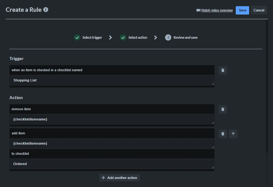

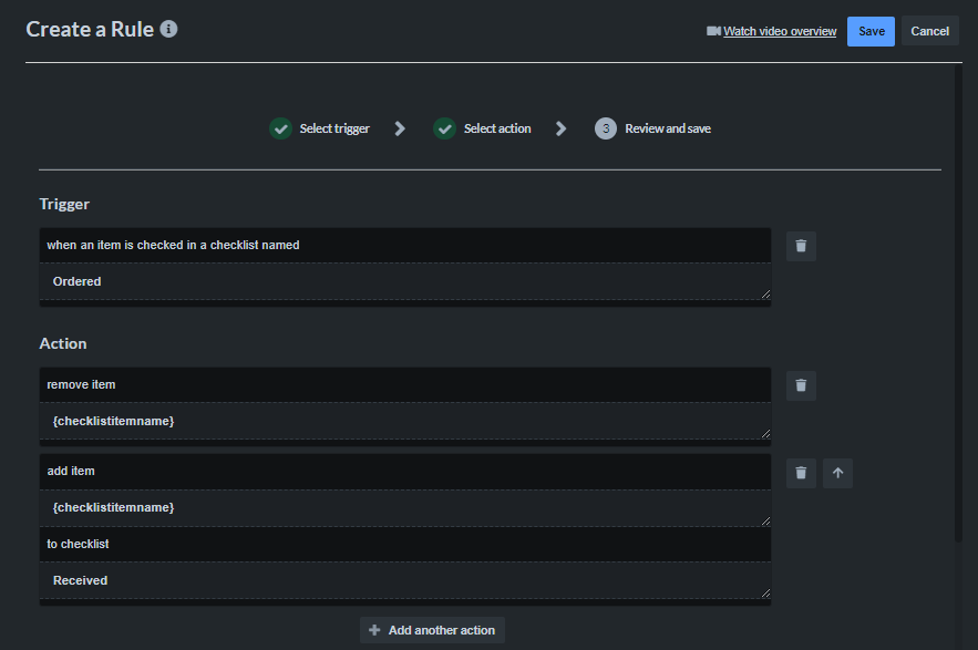

And these are the 2 simple automations used...

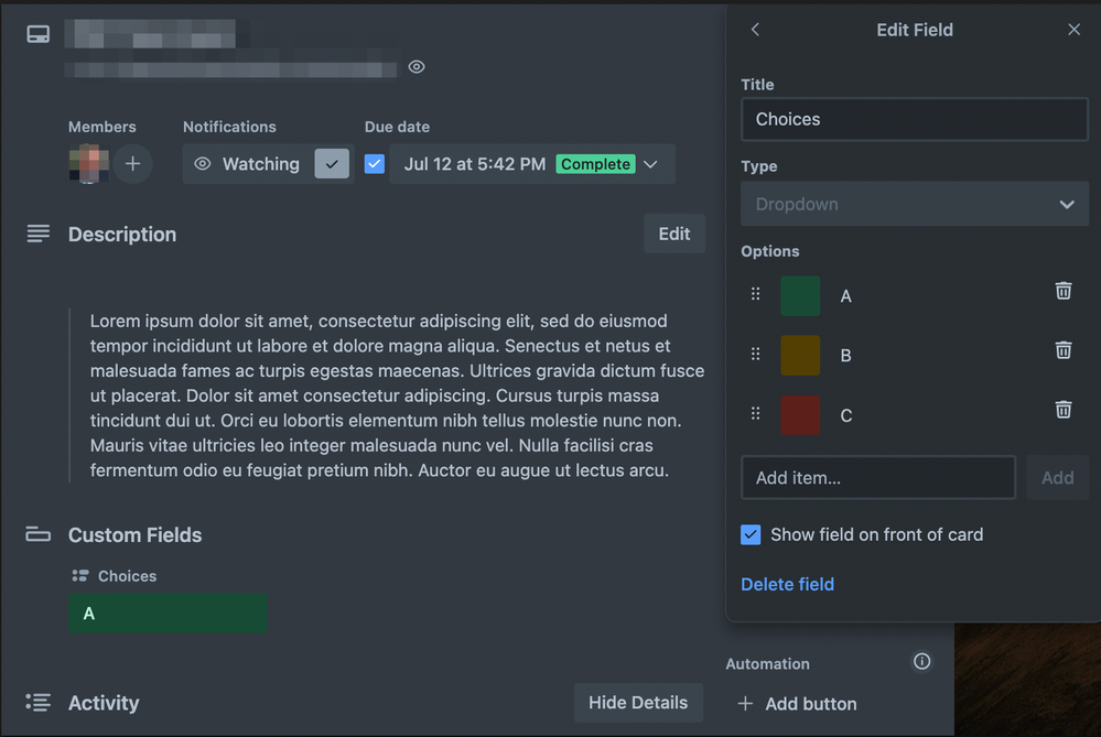

If you're looking specifically for choices, the checklist doesn't seem like the best solution. In this case, since you mention custom fields, I wouldn't necessarily recommend the checklist for the same reason, but perhaps the Dropdown field would work a bit better, what do you think?

The dropdown option only seems to work for one choice. I need to be able to choice multiples somtimes. I'll look into the Power-Up Directory...
