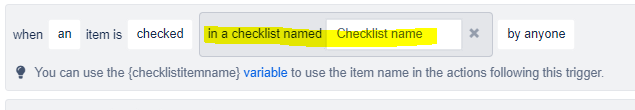

I appreciate your help here. I think this is what we need and assume this is under the Checklist trigger. However, I couldn't find the the automation which says "when an item is checked in a card...".  It just say "when an item is checked in a checklist named..." and no other option to choose from. Let me know if I'm missing something here. Thank you so much.

@Grace Vargas you can just select the "+" to add the trigger without specifying the checklist ☺️

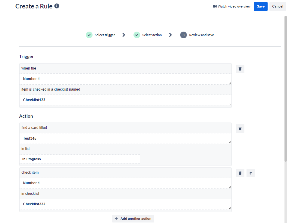

I think the Cascade feature of automation is what you need, but there are some limitations. You will have to know what the item and checklist are called in order to search for it on another card on another list with a different checklist. The screenshot below would show you what that automation looks like.
And when you check "Number 1" that item will also be checked on the other checklist.

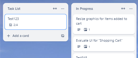

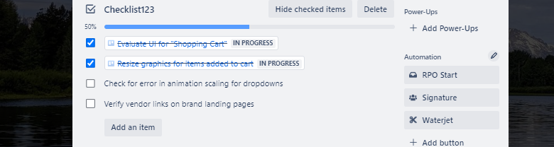

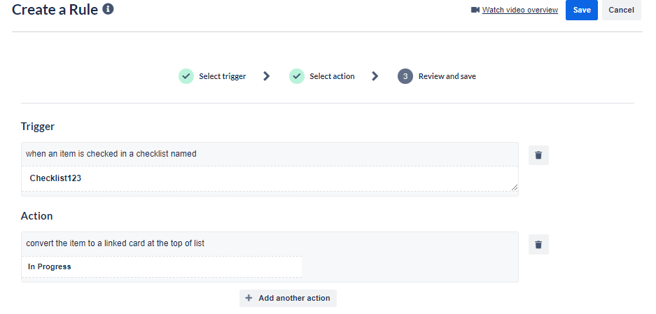

If you would like it to be more freeform so you wouldn't have to know what the items are called ahead of time you could turn any completed items from you Task List checklist into individual cards that could have as much (or as little) detail as you wanted in the Progress List with the following automation.

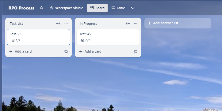

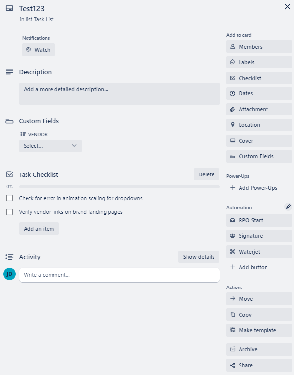

Depending on the answers to the above questions, I think I have it mostly figured out. Your automation will have to use a variable. So, the screenshot below represents my test board for your issue.

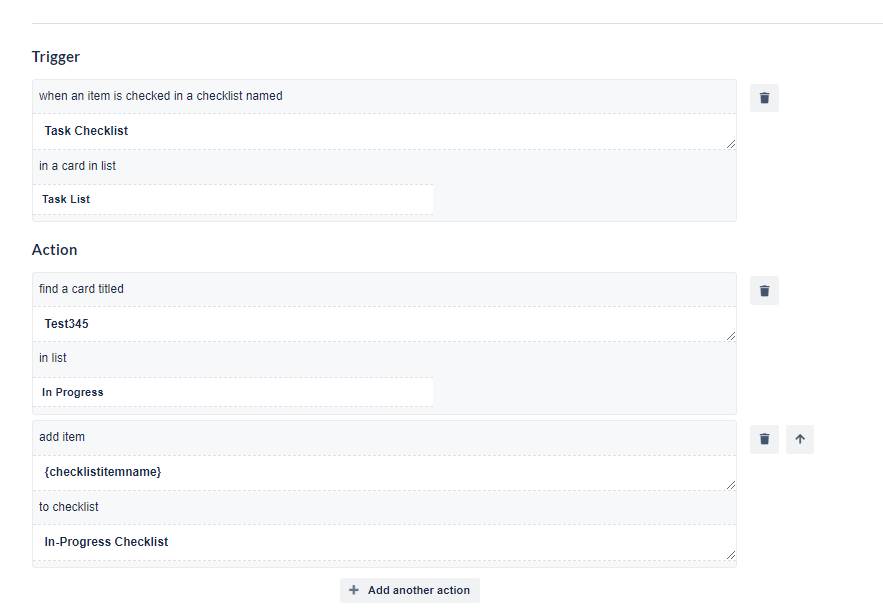

So, the automation you will use will look like this.

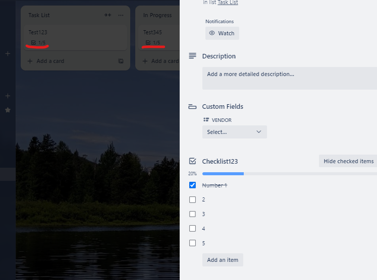

The trigger is watching for checked items on a defined checklist name. When it sees that any item has been checked on that list, then it looks for the card in your In-Progress list with a defined name. Then, using the {checklistitemname} variable, it just adds the previously checked item into the new checklist.

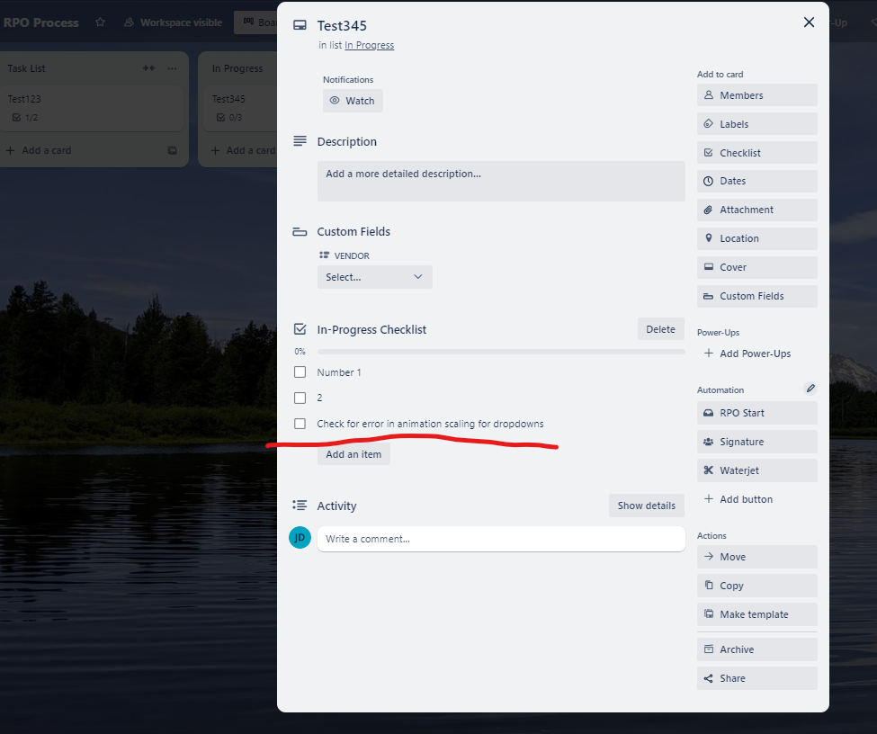

Here is what it looks like in the cards.
It looks like this accomplishes what you wanted, but in this example defining certain names is crucial. There may be a way around that though, I just didn't know if you would always have that info ahead of time or not.

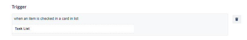

Ok, that helps. So, you can generalize the Checklist/Card name by just having the trigger activate for any item checked in a list like so.
But from there I think the command for the checked item needs to know where to go and needs some specifics.
