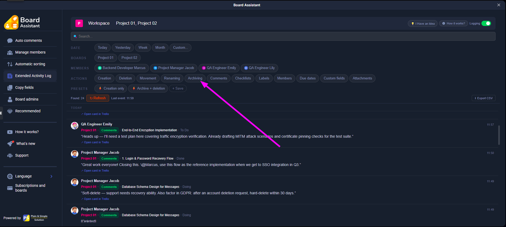

For a no-code option, try Board Assistant: https://trello.com/power-ups/685016dd47b5654ae385bba6
It has an Extended Activity Log with filter presets. You can filter by archive/deletion actions, date range, board, member, and then open the needed card directly in Trello. That should make it much easier to find the archived cards from a specific period without restoring cards at random.

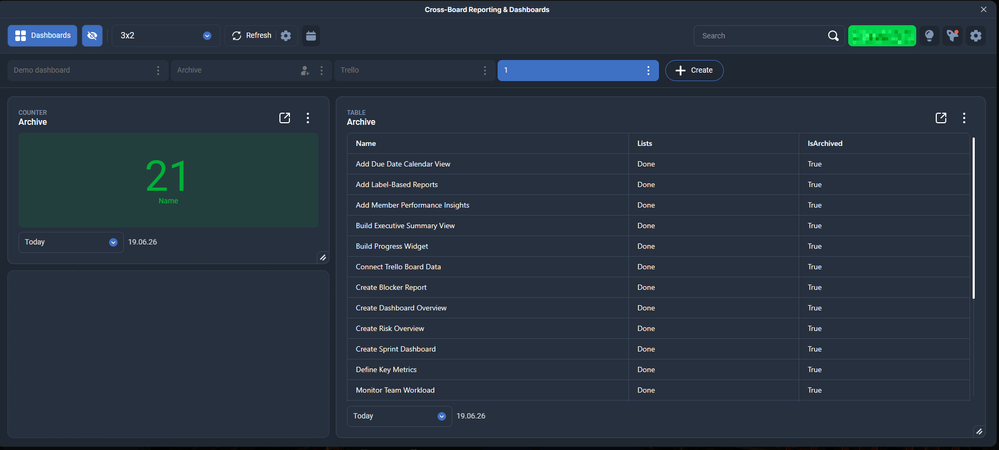

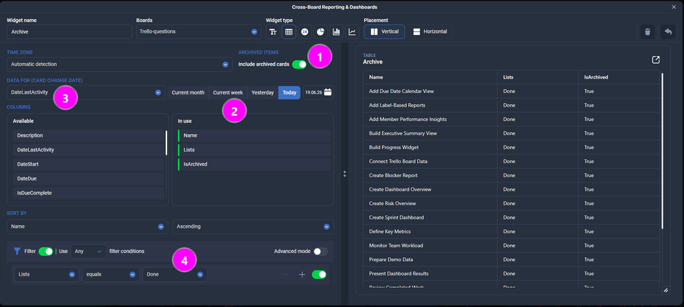

Since you also need reporting, you can also try Cross-Board Reporting & Dashboards: https://trello.com/power-ups/66291013ec3abfbf13b255c6
It can include archived cards in reports and show fields like card name, list, and archive status, so you can build a table/report for the specific list or month instead of restoring cards manually.

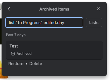

Would using operators such as list:"name" work here? For example, when looking at archived items, you can use this operator and parameter to show archived cards from that list specifically 👀
