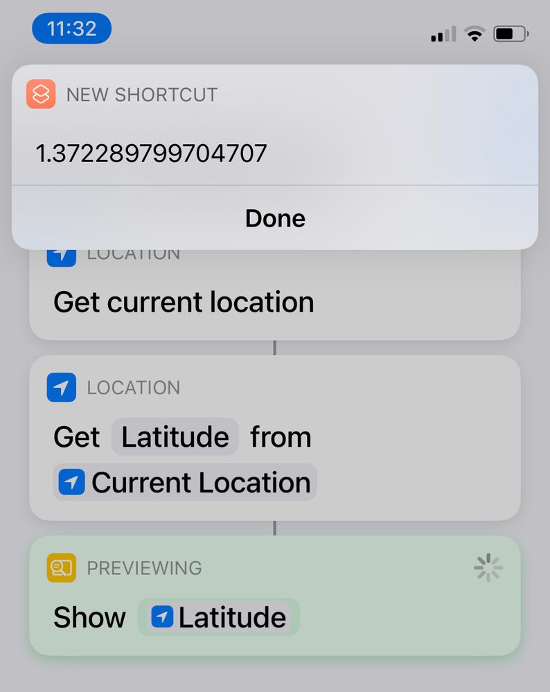

milynnus
March 29, 2021
@Romain H
Yes, this is no longer about Trello.
In ios Shortcut, there is Get current location and Get <> from Current Location...<> could be Latitude if that is what you wanted. We should take this offline.IMG_5934.jpeg
milynnus
March 30, 2021
@Romain H
https://www.icloud.com/shortcuts/aec7e3e263d2428aa43fc10f6aa8a1e4
This shortcut fetches current location calls a openWeather api and create a card in Trello. You will need to change the destination details.
