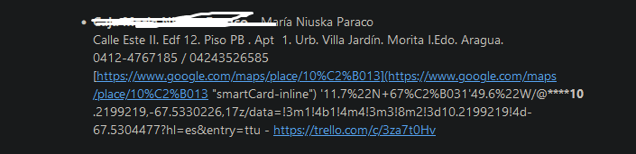

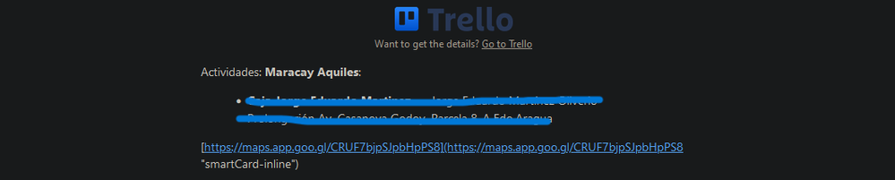

Is there a way to keep the links in the email report without it appearing with the smart-inline and that format? I would like it to just appear as the link
This is the way I designed the automation activity

Neat, but I have the links *inside* the description; I just need the link inside the description to appear without being recognised as a smartCard

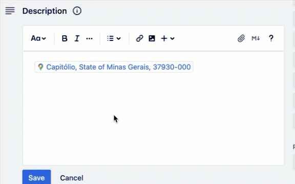

I did some testing here and the only alternative to remove the smartlink word from the URL I found is to change the card description and the link display option from "inline" to "URL"
Here's an example:
I know that might not be exactly the solution you're looking for, but this way, when you receive the report, it will not show the smart link word in the report, although depending on the URL you will see it twice.  If you use a lot of google maps URLs, a test you could try is to use the URL in the share option in the map, which is shorter than the page URL.
