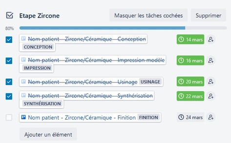

  • This is the checklist from which the card were created :

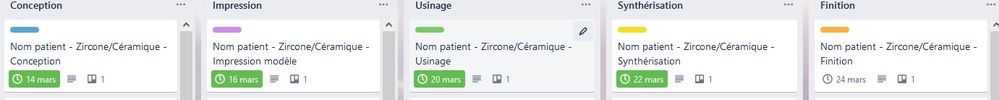

  • Those are the cords with the corresponding due date marked as done or not;Screenshot_45.jpg
  • The cards done/not done status sync well with the checklist thanks to the functions :
  • when the due date is marked as complete in a card, find the first card linked in the attachments, and check item "{triggercardlink}"
  • when the due date is marked as incomplete in a card, find the first card linked in the attachments, and uncheck item "{triggercardlink}"

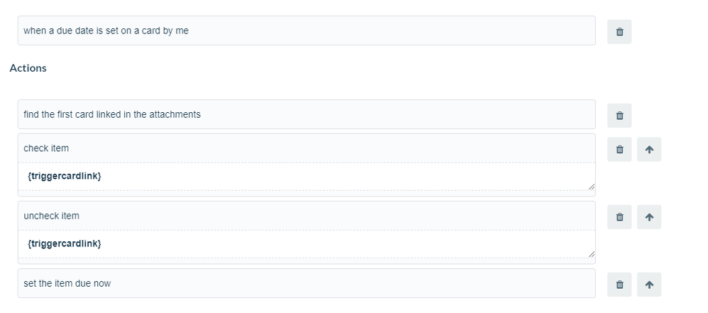

There is a slightly ugly solution and it would work best if you have an automation "bot" on your board instead of tied to your account.
The check/uncheck brings focus to that checklist item and then you can set the date.

Thank you for your answer!
This works but it sets the time as of today. While I want to set the due date checklist the same the due date card, which can be at another date.

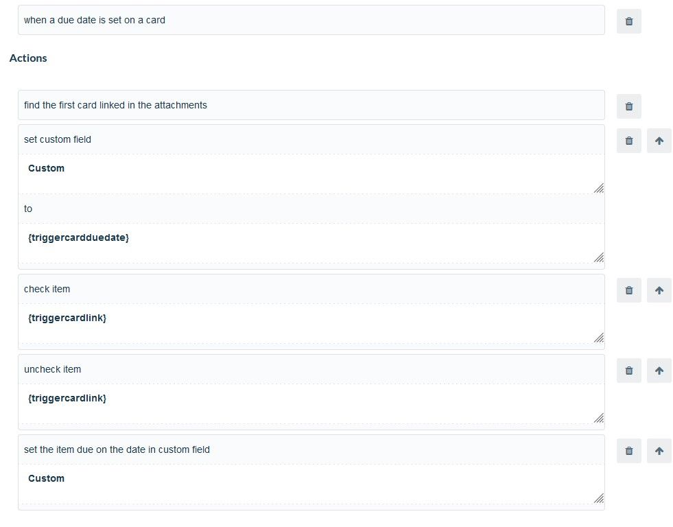

Try this:
when a due date is set on a card, find the first card linked in the attachments, set custom field "Date" to "{triggercardduedate}", uncheck item "{triggercardlink}", and set the item due on the date in custom field "Date"
