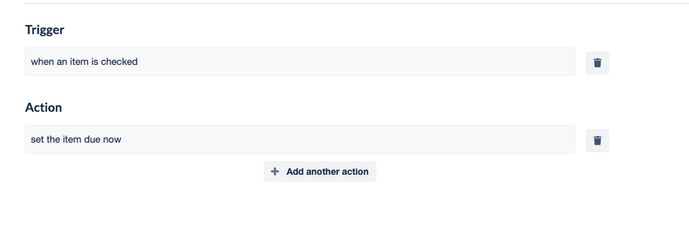

@Heathar Parker are you trying to log a "done" date for a card or for a checklist item?
Either way, there are lots of ways you could set up what you're trying to accomplish!
If it's checklist items, you could make an automation that says when an item is checked, set the item's due date to "now" (which would effectively create a timestamp of when you checked that item).
You could also create a custom field on the card called "Done" and use another trigger, like a card button, or completing an entire checklist to then set the custom field "Done" date to the "now", which would be when you trigger the automation.

I’m wanting to mark a checklist item, so I can have a timeline for disciplinary events. (Heaven help us all if I ever have to complete that list!)
 I ended up making an automation to make the due date the date I checked the item off; I just worried that it would eventually show as overdue.
