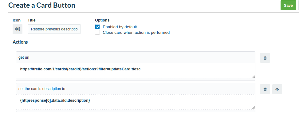

@Iain Dooleysure, here's a screenshot:
I am aware that the response is a blob of JSON, but according to this documentation:
When the response is a JSON object, this variable offers an access notation to retrieve properties within the object, e.g.: {httpresponse.myproperty}
For example, the following command in a card button will post a comment with data extracted from a JSON file retrieved with a GET request:
get url "https://example.com/movie-search?q={cardname}",
and post comment "Result count: {httpresponse.relatedMovies.length} \n\n First result: {httpresponse.relatedMovies[0].title}"
So I would expect it's ok to retrieve the data from the response in a way that is presented on the screenshot.

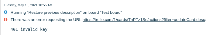

Anyway, by looking on the Butler logs, I think it never gets to the response. Here's the Butler log if that's helpful:

@Joanna hey that's neat I didn't know that about the json response thing.
It looks to me as though the problem is that there's no session data passed in with the URL, so you're not authenticated to view the card when requesting as Butler.
Fortunately you can just put your API key and token into the URL:
get url "https://trello.com/1/cards/{cardid}/actions?filter=updateCard:desc&key=YOURKEYHERE&token=YOURTOKENHERE", and set the card's description to "{httpresponse[0].data.old.desc}"
Note that it's "desc" not "description".
You can grab your API key by clicking this link:
https://trello.com/1/appKey/generate
You can then grab a token by putting that key into the following URL where I have KEYGOESHERE and then going to the URL:
https://trello.com/1/authorize?key=KEYGOESHERE&name=RecoverDescription&expiration=never&response_type=token&scope=read,write
Replace YOURKEYHERE and YOURTOKENHERE with the key and token you generated with those two links, and viola, your Recover Description button will work! It's pretty cool actually I might use it :)

@Iain Dooleyahh yes, I was suspecting this is an authentication issue.
I checked out your API key/token instructions - works like a charm!
Thanks for your help! :)
