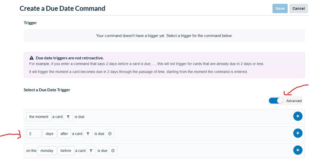

@KatharinaYou can add and remove labels on a card based on the due date.  See the Due Date commands in Automation.

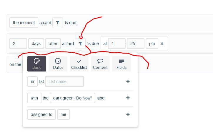

You can use the filter options to apply the rule to a specific list or to cards with one or more specific criteria

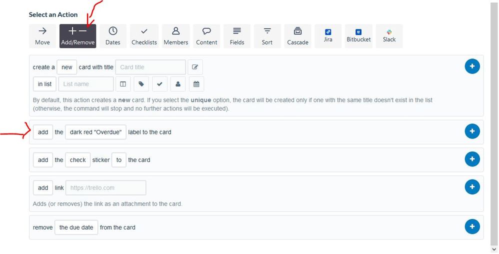

Once you design your trigger, you can add one or more an actions.  (e.g. Add the Red Overdue label)
One thing to be aware of,  some of the automation rules do not work "restroactively". That is,  they will only work on due dates occuring after the automation rule is created.   In other words, automations do not work when the due dates occur before the date the Automation rule was created,
