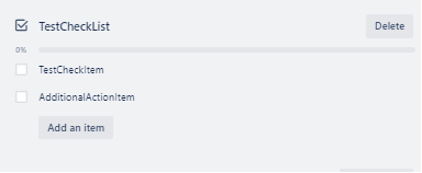

Each of the two has the same checklist on them as shown in Board Snippet2.

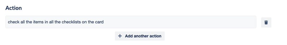

@Ayoade ADERELE thanks for the tag! I didn't see responses til you tagged me.
Could you use the check all the items in all the checklists of a card action?

@Brittany Joiner Yes, they all have the same name.
The cards are all named TestCard
The checklists are all named TestCheckList
The items are all named TestCheckItem
