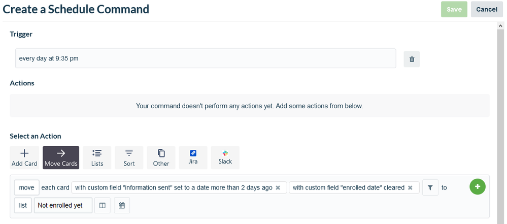

Here is what the construction of the calendar version of the rule would look like using the Butler interface:
Like milynnus likes this
LKM Dance
May 11, 2021
Wow!  Thank you so much David, that made it so much easier for me to follow (so many options to choose!!)
