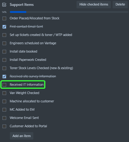

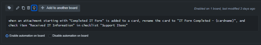

I currently have an automation configured that should tick one of my checklist items when an attachment with the name "Completed IT Form" is added to the card.

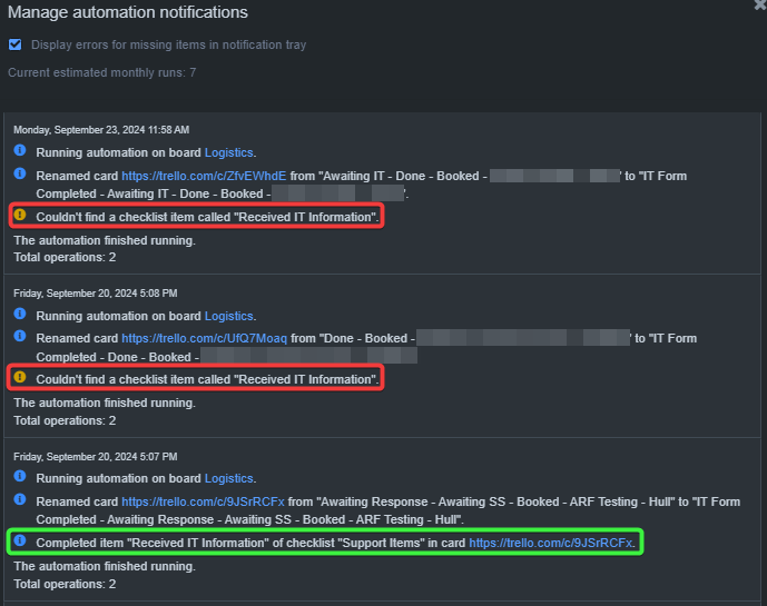

I'm having an issue at the moment where the automation can't seem to find the checklist on the card when trying to run the automation so I'm unsure why this is failing. This works fine on my template card I have set up for testing (duplicated from actual template we use for other cards) but the real cards seem to fail with no obvious reason.TrelloAutomationLog.pngTrelloChecklist.png

@Alex Figgett hmm, im not seeing anything obviously wrong. for kicks and giggles, could you change the step order so it checks off the item before renaming the card? I don't think that would matter but maybe try that.

Changing the order unfortunately makes no difference to the rule - the renaming function works fine while the checklist function does not.
We copy the template cards manually using the in-built "Copy" button in the cards and then just rename the new version of the card through this process.

Sorry for the delay in coming back to you on this, the automation strangely seems to have started working on almost all cards without any further changes.
I did test the entire automation against a button initially and had no issues so then went on to create the rule instead.
