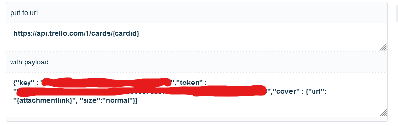

I am trying to copy the cover from one card to another using Butler HTTP requests. I was able to set the colors this way but when I tried setting the cover like this : Screenshot 2022-04-10 235023.png
It gives an error:
Since the file is already uploaded to trello shouldn't this be an allowed image service?
Is there any way I can set the cover? Is it possible by getting the attachment id? If so how?

As per the REST API documentation for the Update a Card endpoint, if you want to refer to an image using the url parameter, you can only refer images that are hosted in Unsplash for the cover:
url. Used if making an image the cover. Only Unsplash URLs work.
Urls to any other image location / place are not allowed.
To use an image that's attached to any card as the cover for any other card, you have to refer to it by its ID:
idAttachment. ID of an attachment on the card. Used if setting an attached image as the cover.
However, Butler currently does not have a variable such as {attachmentid} that will return the ID of an attached image, so there is no way to automate that aspect of the rule.
You are essentially stuck with having to manually put the ID of the image into your HTTP PUT request in your Butler rule:
{"key" : "[api_key]","token" : "[api_token]","cover" : {"idAttachment" : "ABCD1234etcetc","size" : "normal" }}
 Bummer, eh :)

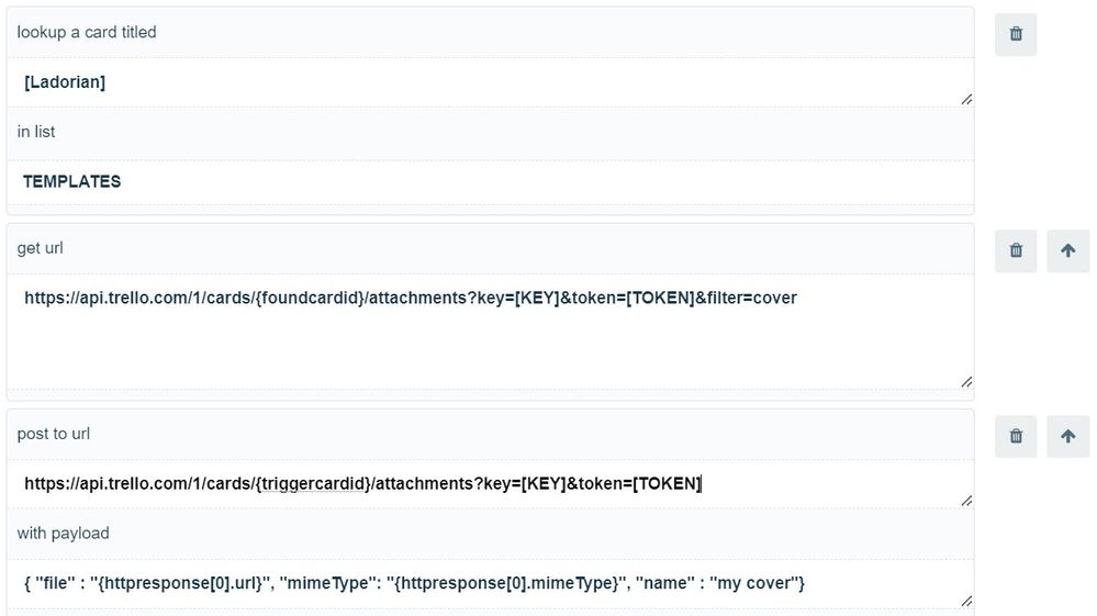

I was trying to find a getaround and I'm pretty sure it's possible but I may need some tweak.
My idea was:
  • Look up at the card I want the cover from
  • Get the cover attachment
  • Put this attachment as a new attachment of the destination card, defining it as a cover.
My rules look like this
It almost works as I have a new attachment in the destination card but it's not an image, so if I use "setCover": "true" in the last payload, I get the following error message.

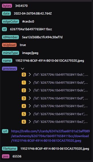

I don’t work with native Trello api a lot but based on your post, the issue is not the setcover but you did not get a image file as you indicated.
I am able to get this if I make one of the attachment as a cover vs a cover that is taken from the unsplash. Same results when I used the python library and native api call.
Do note the url structure.

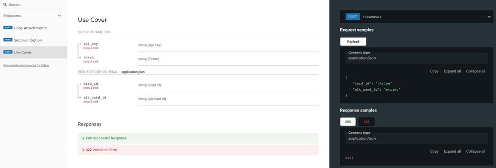

Creating the endpoint proves to be a bit more challenging than I thought.
  1. You cannot use the url because it complains about being unable to generate a preview.
  2. If you download and use the file, you cannot setCover at the same time
I have not done the documentation. Here's from redoc. Use the same endpoint from the documentation earlier in the post.
note: there is a 10s timeout which will affect large cover files.

I'm not sure to understand what you did in 2 as I don't know what redoc is.
@[deleted]
thanks to you too but your approach works when the image is already attached to the card. In my case, I want to use an image from another card and the problem is that I'm able to copy an attachment from a card to another one but only as a link, not as an image. That makes the new attachment unavailable to use as a cover. I don't find the way to copy the image as an image.
From the Get request I don't get the image as data, which is what is expected according to the API
file
string
The file to attach, as multipart/form-data
Format: binary
I'm not an advanced coder, so I don't know if there is a way to get the image as data before setting it as an attachment to the new card.

redoc is the documentation of the API. This is how you use it in a card button in Trello
create a new card with title "{triggercardname} : New" in list "Inbox", and post to url "https://moklxc.deta.dev/usecover?api_key=1......................7&token=be...............b4" with payload "{"card_id" : "{triggercardidlong}", "alt_card_id" : "{newcardidlong}"}"
Remember : use it with a trigger card that is using an attachment as its cover and not something from Unsplash.
BTW : I have updated the documentation
https://github.com/xu2xulim/Superhero/blob/master/Superhero%20on%20deta/Micros/Attachments.md

You can't just 'copy' an attachment from one card to another. Trello and the REST API's Create attachment on card endpoint expects you to create a new attachment per card, and you have to do that by supplying the file's data as multipart/form-data.
Unfortunately, the REST API's Get attachment on a card endpoint provides no mechanism of extracting the raw data of an existing attachment, only the information about it, like the id, date, bytes, name, url etc.

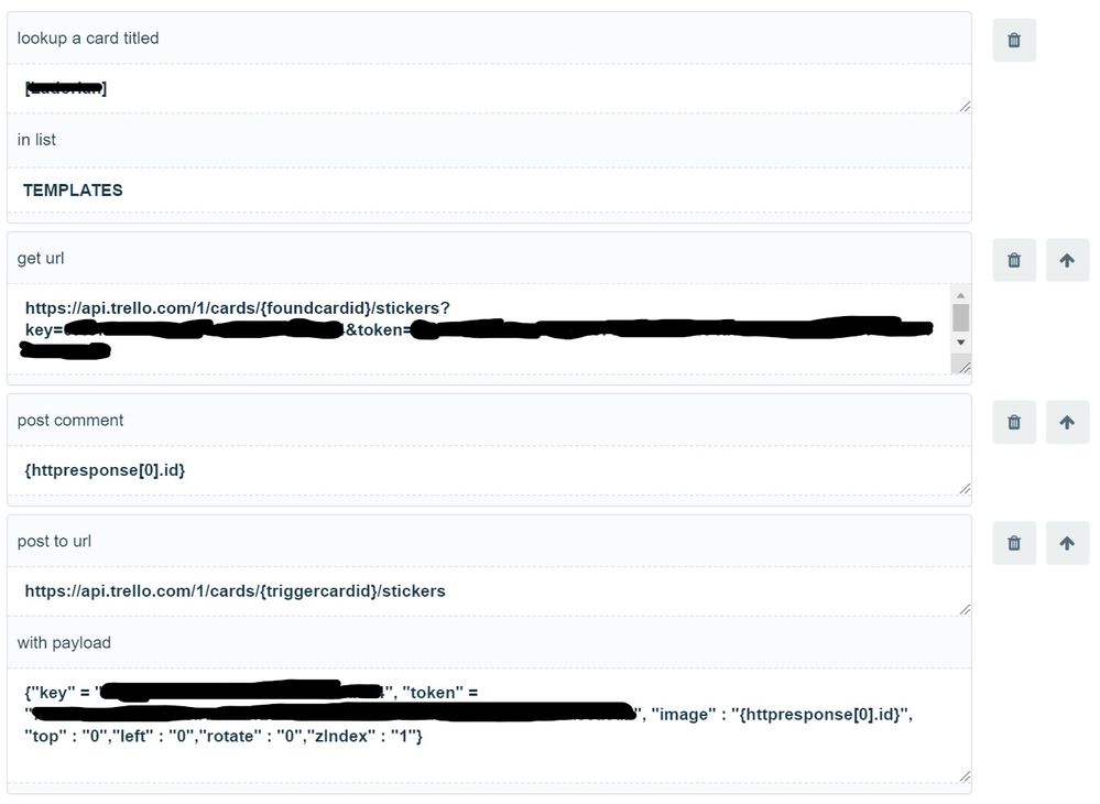

I mean. I created the custom sticker. I do get the expected results from the get request (I put it in a comment to ensure there was something usable) but when it comes to the POST part, it gives me an error:
400 Error parsing body
This is the workflow.
I tried with httpresponse[0].image too, just in case but it has the same effect.
Deleted user
May 12, 2022
@Thomas
I think you need to more closely read the information that is being provided.
I've already advised that you can't put {httpresponse[0].id} in a Put request's payload, because it gets parsed as ordinary text, hence the 400 Error parsing body error you got.
You have to actually type in the id of the sticker, directly into the payload:
{"key" : "123456blahblahblah","token" : "123456blahblahblah123456blahblahblah","image" : "627ca47368c7537ba17b6ec5","top" : "0","left" : "0","rotate" : "0","zIndex" : "1"}
.... as per the example I provided.
If you don't want to manually type in that information into the payload, you have to put the sticker's id in an intermediate custom field, then use that custom field in the Put request payload:
{"key" : "123456blahblahblah","token" : "123456blahblahblah123456blahblahblah","image" : "{{%custom_field_that_holds_the_sticker_id}}","top" : "0","left" : "0","rotate" : "0","zIndex" : "1"}
 .... as described in the initial suggestion I provided.

After messing a bit around with all the info I finally got it. I just had to substitute the sticker id with the sticker image.
We'll work with that option for now, hoping that there we'll be an option to copy covers in the future.
Many thanks for your help 🙏🏻
