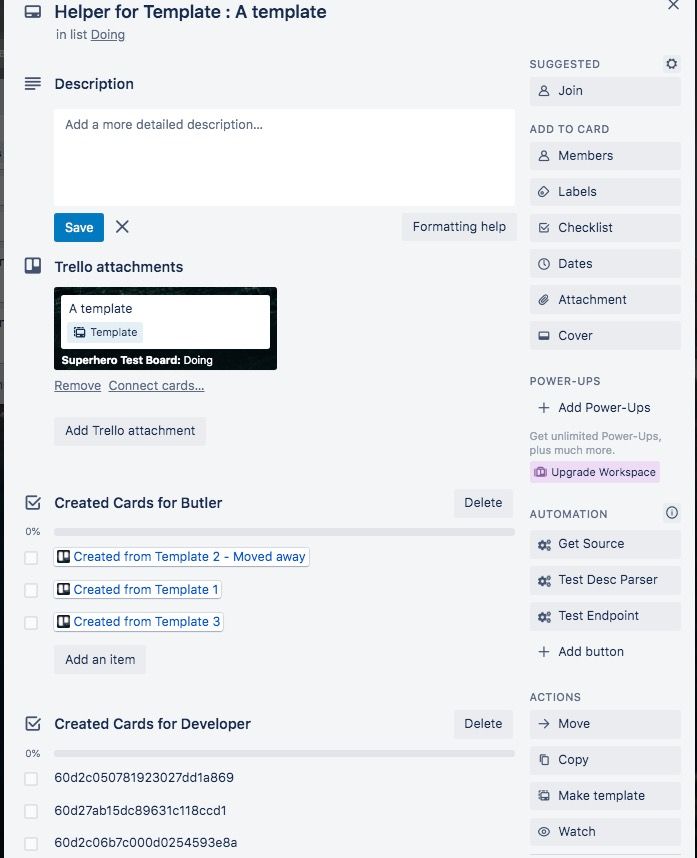

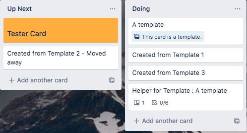

milynnus
June 22, 2021
@Lori Werner
The 'helper' solution is done. I will put it with an endpoint. It can be used with Butler to automate the changes to all card that was created from a template card. It can be used by developers via a http request.
It uses the "cardSource" taken from within the "copyCard" action.Screen Shot 2021-06-23 at 1.35.34 PM.jpgScreen Shot 2021-06-23 at 1.34.58 PM.jpg
