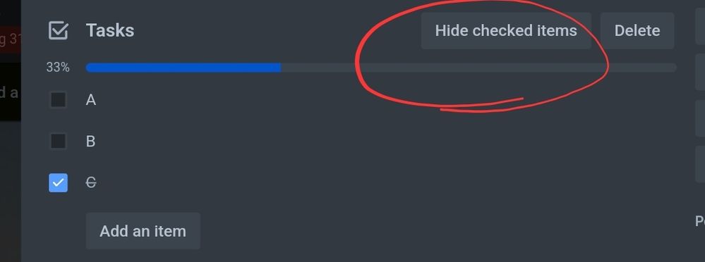

Is the goal to organise your checklists so you can easily see what's incomplete? You could just have one big checklist and then have it so check-items disappear when they're completed like this:
