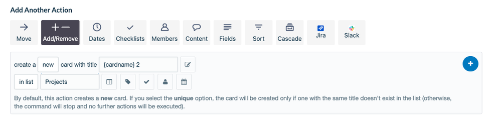

2. Then use Add/Remove and use the top option (shown here)
And you can edit the card name. The {card name} variable will take the name of the original card and use it for the new card. You can add more to this eg I added "2".

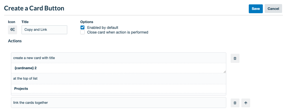

3. then "Cascade" to link the two cards together (the last option on here)

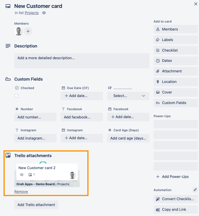

And all being well you will get this when you click the card button on card 1.

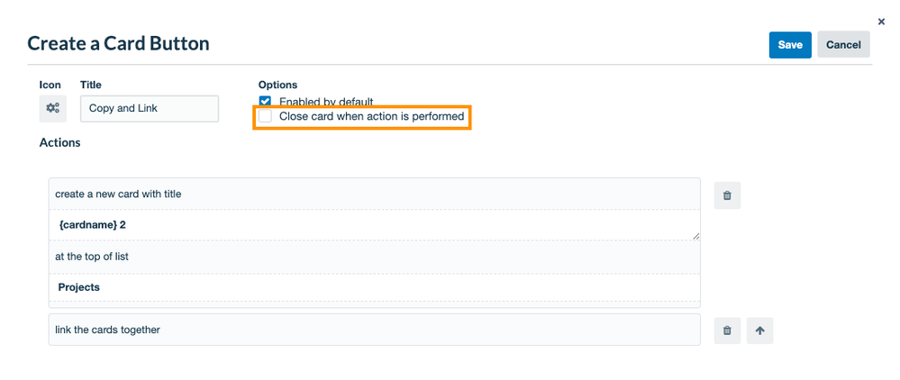

1. To close the card check this box when you create you're card button. I don't think you can auto open the new card though.
