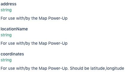

@Iain Dooley
Picture is from Trello API documentation for Update a Card. It seems that something has changed
Like Iain Dooley likes this

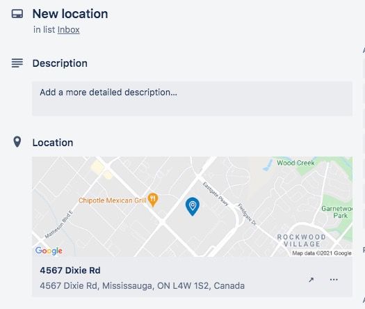

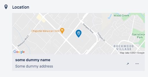

@Iain Dooley
Just managed to update the coordinates, address and locationName. The Map View changed on the card. Basically used the coordinates of New Location to replace the attributes  on the test card...one with dummy address and name.Screen Shot 2021-07-05 at 7.44.51 AM.jpgScreen Shot 2021-07-05 at 7.44.36 AM.jpg
