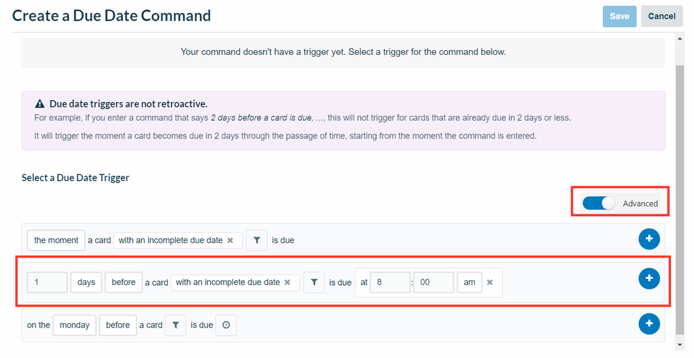

When I used the rules when the due date is marked as incomplete in a card with a due date due tomorrow, add the orange "TRÁMITE POR VENCER" label to the card, and remove the green "TRÁMITE EN PROCESO" label from the card it not add the orange label and not remove the green label.

Hi @Margarita Gomez Lince welcome to the community! It sounds like you might need a due date command instead? Your command trigger is "when a due date is marked as incomplete". What that means is it will trigger when a card was previously marked as complete, and then you marked it incomplete.
What might make more sense is to create a due date command like this for example:
Just make sure you have the "Advanced" toggle turned on in order to add the "with an incomplete due date" condition.
