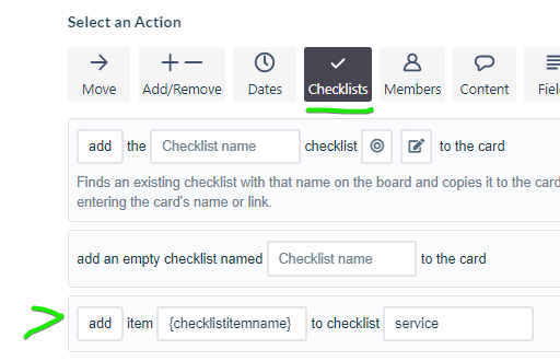

where do you find the action "add item"checklistitemname" to checklist "service"??
Vongsawat
May 12, 2023
Take care to be case-sensitive, and the curly brackets
