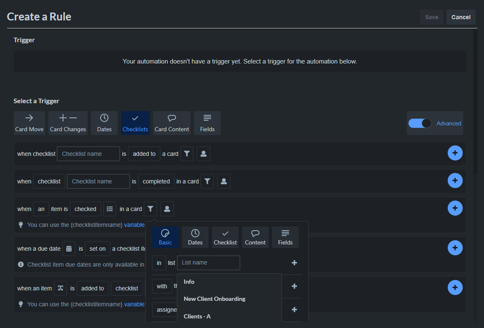

I have a list consisting of cards and checklists that have automations regarding starting the next task, etc.
I need to duplicate this list, but have the automations only be applicable for that list.

I need the automation process to run with the duplication, but for the automations to be isolated per list.
Okay, understood. Originally I thought you were looking to just isolate the automations to the first list and not apply to the duplicated list.
Just to try and understand. You have list A, with automations that execute based on certain triggers. When you copy list A to make list B, do you want automations to be executed on list B as soon as it is created or just when the same triggers occur?
What triggers are you using in your automations?
For the list when you want the automations to exectute, you'll have to modify the automation trigger to include a "in list name..." condition.
