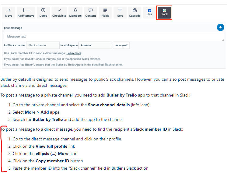

I got the instructions from:
https://support.atlassian.com/trello/docs/using-the-jira-and-slack-integrations/
Here is a screen snip of the instructions:
However, I also found this note below that one, at first I thought it meant something else, but now I know what it means. I now know that the problem was that I was trying to have the message DM people as butler.
