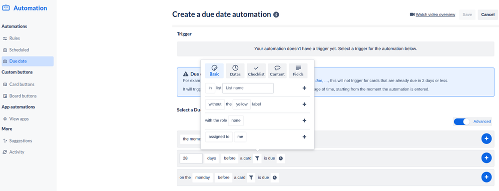

I need to create a scheduled automation rule that performs a specific action on cards a set number of weeks before their due date. However, my Trello Butler interface does not have the options to add the necessary conditions.

  • The automation should not apply to cards that are labeled 'Woodward - Room Only'. (I can't figure out how to do this action)

My Butler interface does not have a clear way to add the condition 'that is not labeled' to the scheduled due date trigger, nor does it have a text-based command option. Can you please provide instructions for my specific workspace?"

I think instead of Scheduled, you should look at due date automations:

Thank you so much. I am learning how to perform automations and appreciate the answer to my simple question. I asked an AI board and just couldn't get to this solution. I appreciate the help!
