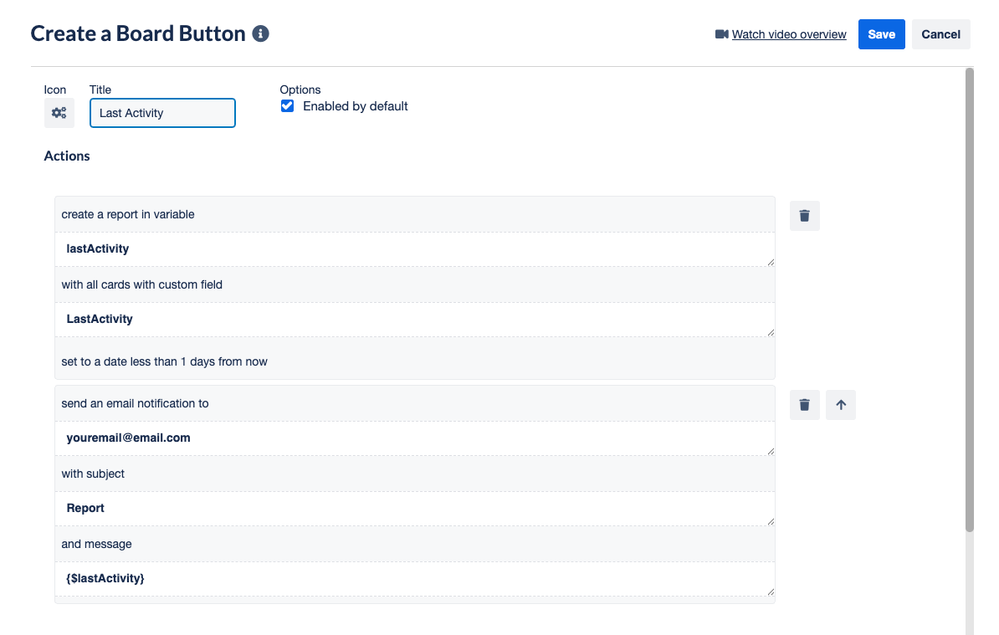

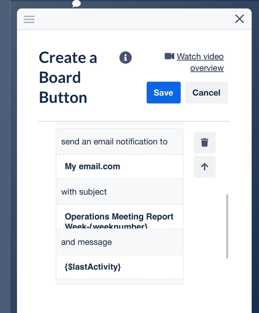

Hi I have followed your steps to make a board button. I’m really struggling though, the email comes through but it has no details. It just says “go to Trello to find out more”
im obviously missing a key part of the code/formula but not sure what it is.

I checked your screenshots and it seems like the report is blank because the variable for the report needs to be the same as in the email body. For example, if your rule says "create a report in variable Meeting_Activity" the variable in the message must be {$Meeting_Activity} instead of {$lastActivity}.
Let me know if changing the message to {$Meeting_Activity} works.

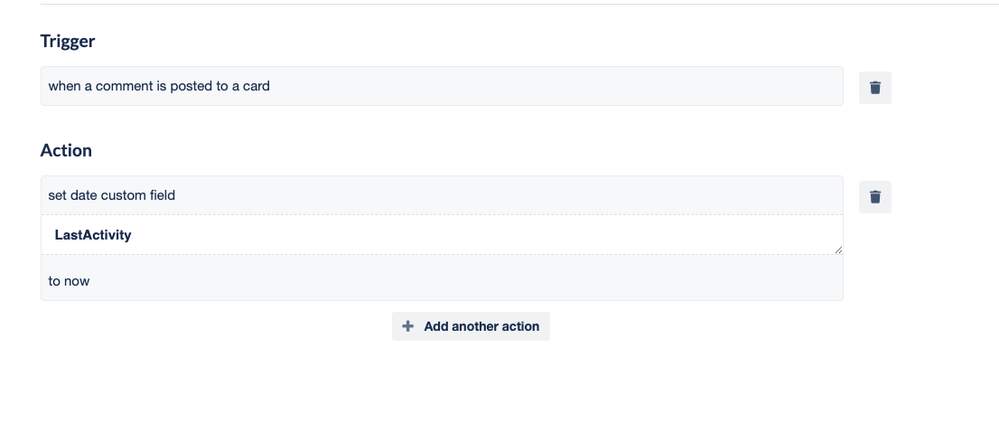

@Paul Tierney you could potentially create your own "last activity" automation that sets a custom field "LastActivity" to "now" when you do certain actions on a card, like you mentioned.
Something like this for each type of trigger, like moving a list, adding a comment, etc:

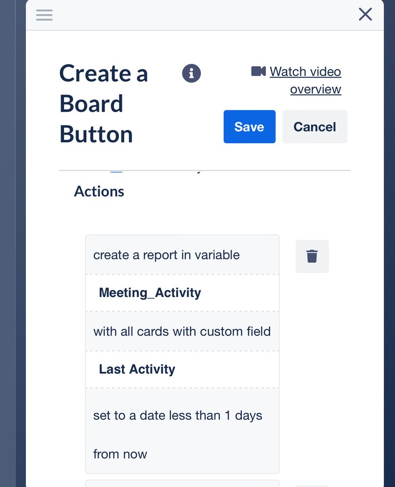

And then you could create a board button like this, which would create a report of cards with LastActivity set to a date less than 1 day from now. (But unfortunately you can't do less than 1 hour, just less than 1 day... but maybe that would get you close enough?)

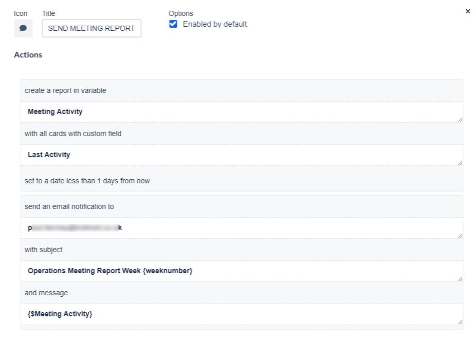

Paul Tierney
October 29, 2024
Carolina Lopez
October 29, 2024
Thanks for sending the screenshots @Paul Tierney!
I blurred the email address because it's a public thread, I'm sorry I wasn't clear when I asked if the email address was filled correctly.

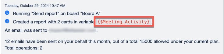

The variable for the report shouldn't contain any blank space. When we create a report with a space in the name, it'll replace the space with an underscore (_). This should be the reason why you're not receiving the report.
If you check the automation log, you'll probably see a log like this one:
Using the variable that appears on the logs will allow you to receive the report.
Let us know if it helps!

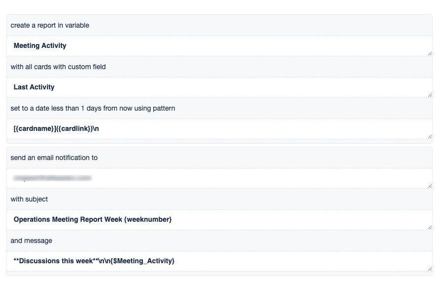

I'm glad that you're receiving the reports! To change the way you view the cards, you can modify the pattern. Here’s one you can use:
[{cardname}]({cardlink})\n
To add a title or any other messages to your email body, you can include formatted text before or after the report variable. Here's an example of how the message might look:
**Discussions this week**\n\n{$Meeting_Activity}
This is how the automation will look like:
There isn't an easy way to add a comment or checklist item to the report, because we're limited to this list of variables, but I'll see if I can find a workaround.
In the meantime, let me know if the report looks better by changing the pattern and the message.
