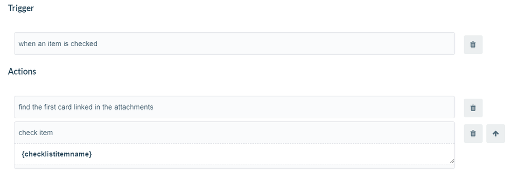

As Milynnus mentioned, you would need the cards to be linked together so that Butler can find the correct card/check-item and complete it. The rule would look something like this:

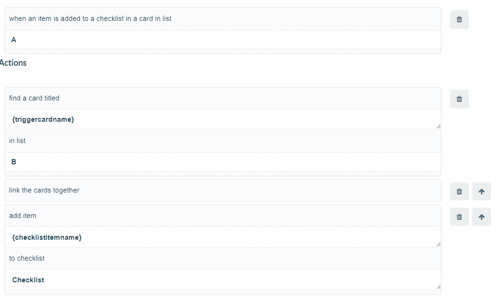

I would also consider looking at automating the part that links the cards together so Butler is able to look up the relevant checkitem - so creating a separate rule that automates the checklist item being added to the card and adding the link. As Milynnus suggested, it may cause looping, so you'd have to keep that in mind when creating the rule. Something like this could work:
Fábio Hagiwara
September 6, 2021
Thanks, your first rule worked exactly the way I wanted. I didn't know that I could use {checklistitemname} to get the the item's name so I wasn't able to find a way around.
