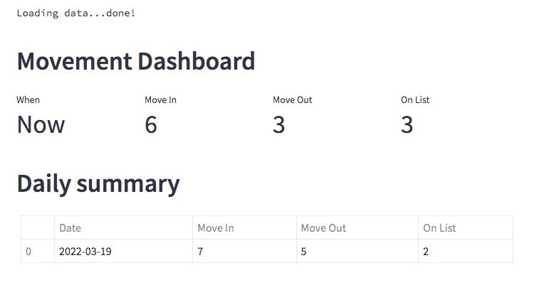

milynnus
March 18, 2022
@Thomas Pierson
I took opportunity to learn how to use Streamlit with Deta Base. Below makes use of a webhook with list_id as the idModel to track the movement of cards in and out of the list.
To build a custom dashboard will take a bit longer. As you can see, I needed a date which can be used to generate different periods.
It is dynamic because the data will be update when you refresh the browser.
